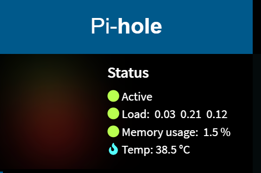

So that's the story of how I got here. Now that I am here, I notice that it is not as responsive as my previous installation, and it almost a constant load of at least 0.3, where before it would be around 0 or 0.1 at the most.
Is there a config I am missing or something wrong in my debug that would indicate why it is so unresponsive at times?

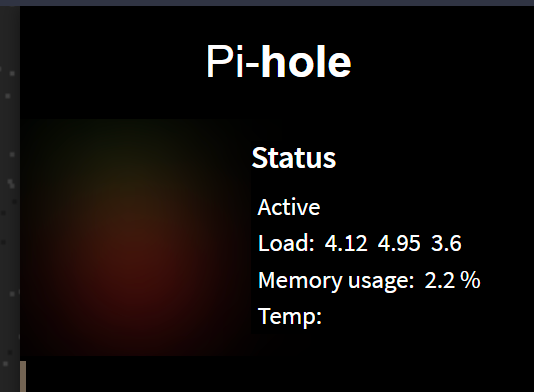

Load goes up to 4 and higher sometimes, the Pi-hole becomes unresponsive at times.

The image btw is at idle, this was not the case before the clean installation.

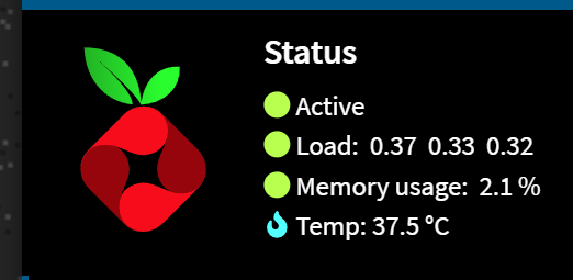

You have a Pi R4 so load averages of 0.37 is effectively nothing.
Yeah, but before that it was even less, like I said it was 0 or 0.1 at most.

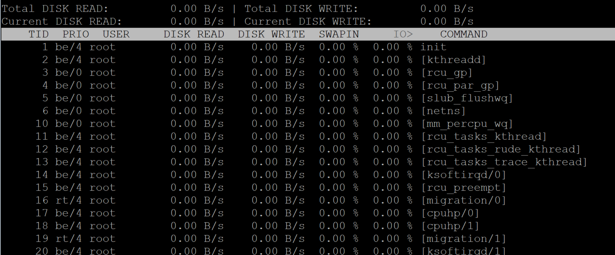

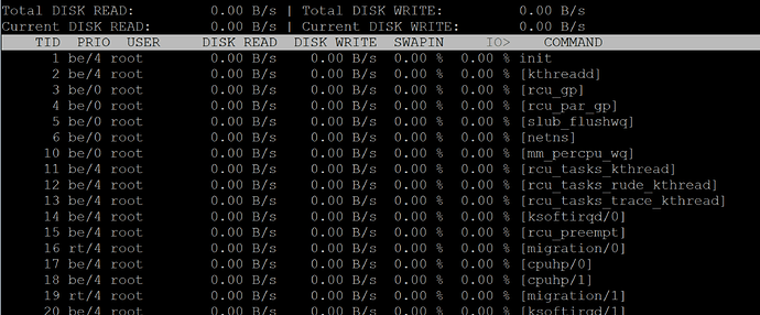

I installed iotop, nothing sticks out as problematic so far.
This is when I try to reach the GUI, and nothing happens. Clearly, no process is using the io. I am baffled.
