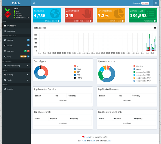

I don't know what a normal dashboard looks like, but mine shows clients, queries, etc. However there is not data in any of the logs. Any clues appreciated. Thanks
https://tricorder.pi-hole.net/rpYeAjGw/
Because you have configured Pi-hole to not log queries:
   [misc]
     privacylevel = 3 ### CHANGED, default = 0
"New install is not blocking anything"
Your dashboard shows that 7.3% of queries are blocked.

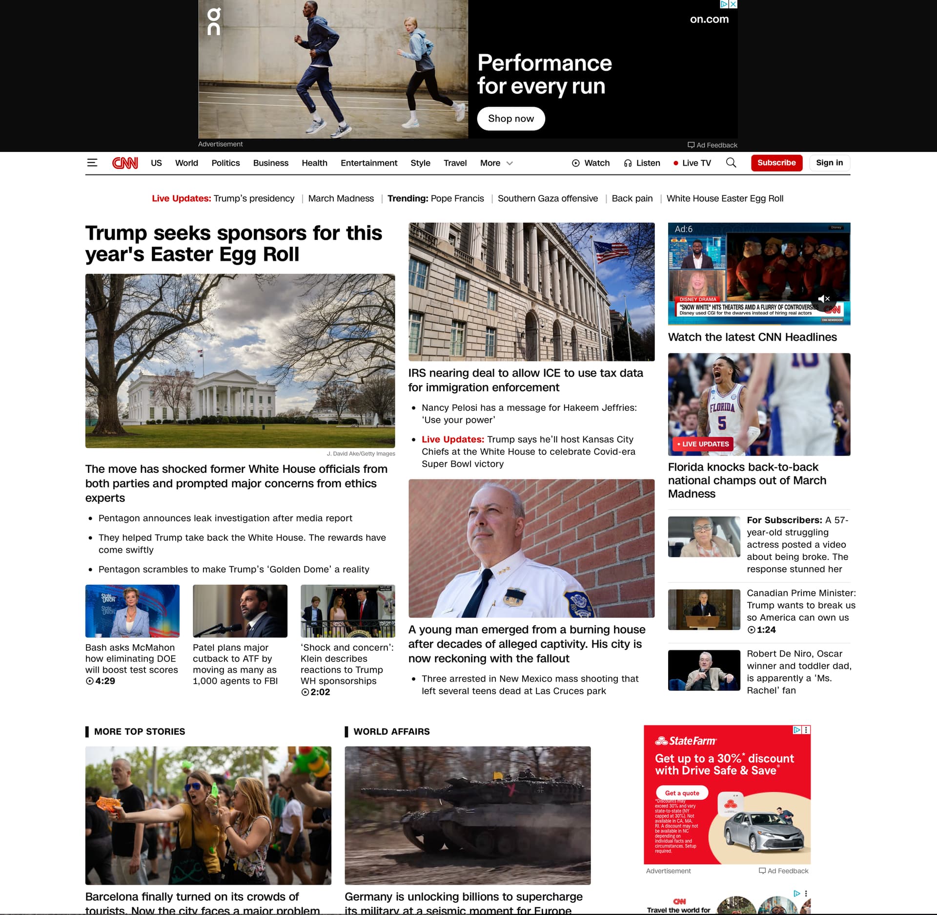

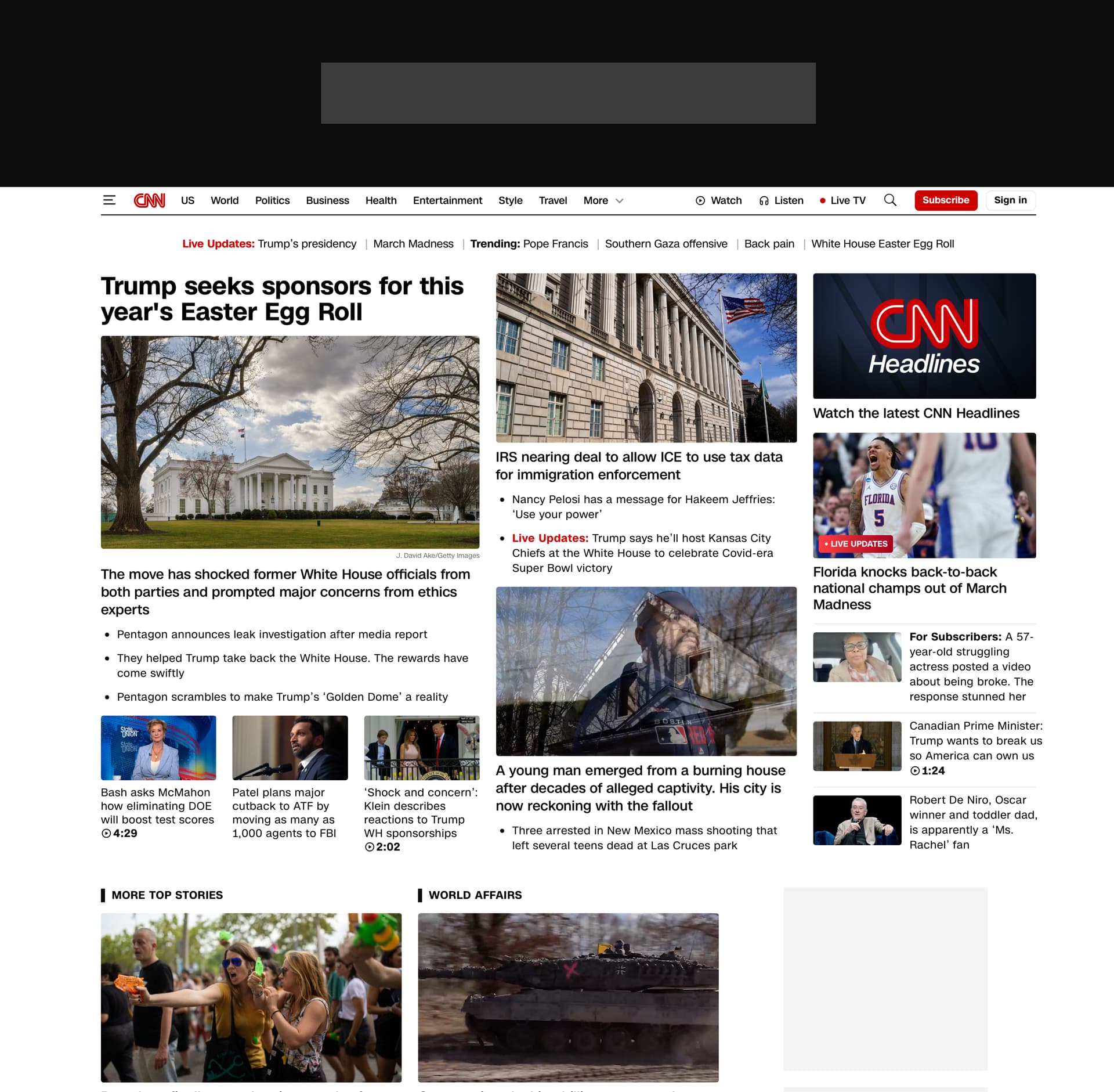

Most of these adblock test sites are fairly meaningless. They use a set of domains that you may or may not ever encounter in your normal browsing or internet activity. Whether you can block those domains or not has little bearing on whether you see ads in your daily internet use. And, if the browser on which you ran that test is using a DNS other than Pi-hole, then the test is even more meaningless.
The real test - do you see ads in daily browsing. A good "test" site is cnn.com. If you don't run a Pi-hole, the site is crawling with ads. If you do, you don't see the ads.
The site with Pi-hole (and no other ad-blocker) active:
The same site without Pi-hole or any other ad-blocker in use:
Daily Mail, Yahoo and other sites are also good "test" sites.
You're right. CNN crawling with ads. However, for me with or without pi-hole. I appreciate your unexpectedly fast response. I'll play with it some more. Thanks
