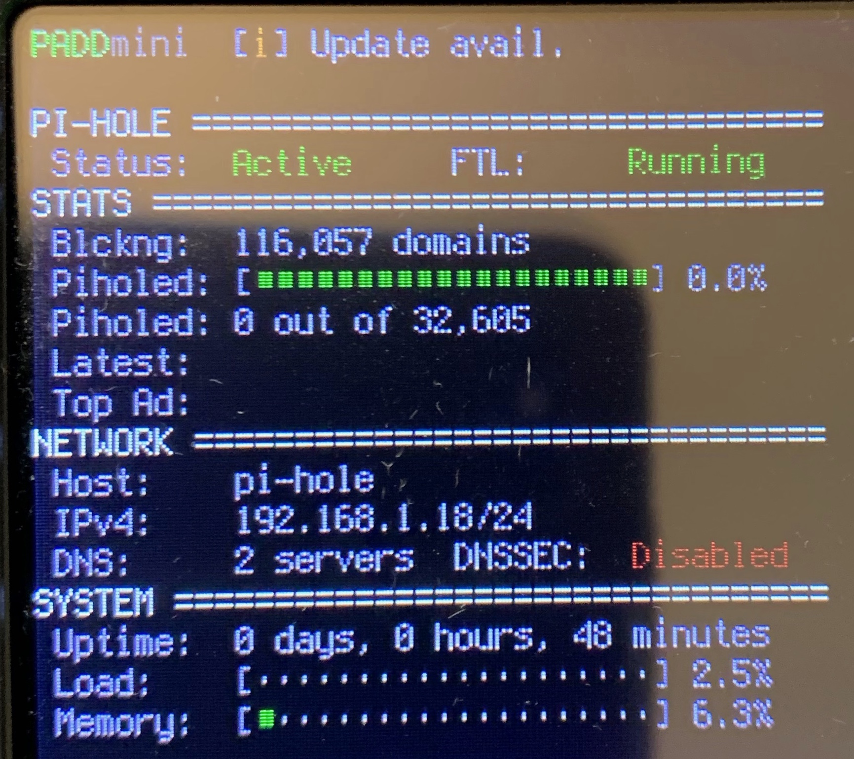

The pihole still thinks its' I.P. address is 192.168.1.18:

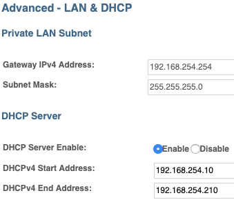

However, the new Frontier router only assigns addresses from 192.168.254.10 to 192.168.254.210:

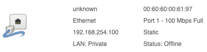

In fact, I can see the router gave the pihole 192.168.254.100 instead of 192.168.1.18:
Unfortunately, I cannot ssh into the pihole at 192.168.254.100:

It looks like on the router you have the option of changing the local IPv4 range (they don't appear to be grayed out). In the Gateway, use 192.168.1.1, and in the range use the range 192.168.1.10 to 192.168.1.210. Then reboot the router and renew the DHCP lease on all the clients.
or statically assign your Pi an IP outside the router DHCP range and set the routers IP as the Pi's default gateway
eg 192.168.254.253 with a netmask of 255.255,255,0 and a DGW of 192.168.254.254

I'm not sure why Frontier has their router (Arris NVG468MQ Gateway) configured with the higher i.p. addresses? Maybe your local network is less likely to be hacked using higher i.p. addresses? Maybe it has something to do with their service? I don't know.
In any case, whatever their reason(s), I decided to leave the addresses as they are (for now), and I tried re-imaging the pi-hole. It took a while to re-image, reinstall, and reconfigure everything. And in the end, I still couldn't get it to work; even with the pi-hole using 192.168.254.10.
