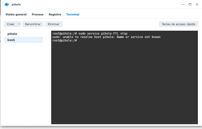

Where i can use these commands in my nas? i have tried enabling ssh and then from windows 10 cmd log in, but after typing the first command it says "sudo: service: command not found"
I found in the docker settings of pi hole a tab with terminal, is this place where may i have to run these comands?
Yes, with a dockered Pi-hole, you'd have to run them inside the container.
You could also stop your container, remove the db from the mounted directory of your host, and restart the container, but that would require that you had configured your container to expose /etc/pihole/ (which we don't know from what you've shared so far).
The commands i have writed it seems that the have nort worked but later terminal says that ftl was stopped, after that y shutdown and restart pi hole and now it works (this is something that i did few times after write in the forum)
I don't know why but it works now
thanks for your help!
