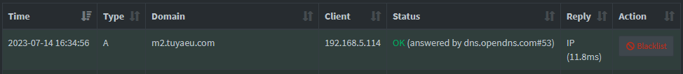

Query log in Pi-hole looks like this:

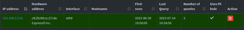

Tools>network looks like this:
It's similar in any network scanning tool I can think to try:
IP, MAC, no hostname
I guess those last two nslookups show the issue. scanning software was OK without pi-hole involved though.. so it's got me a confused tbh
Those two nslookups show that your router's internal DNS server does hold the A records for Smart-Consoles, but not the respective PTR records.
Pi-hole would need correct PTR type replies in order to associate observed IP addresses with hostnames (the same would be true for other services as well).
Your router's DNS server should be good enough to access hosts by name, but if you require reverse lookups to work, the best way to ensure that would be to create Local DNS Records in Pi-hole.
