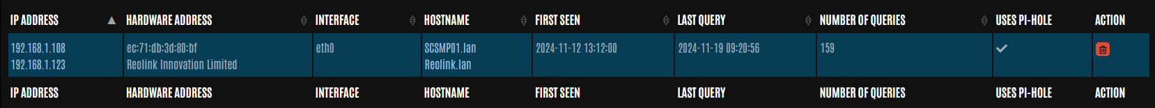

Here's an example; there's a Reolink Hub on this network which should have 192.168.1.123, but DHCP leases have clearly renewed and re-assigned it 192.168.1.108 - except that is named SCSMP01, a friend's desktop I worked on months ago.

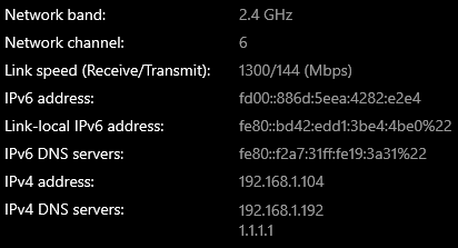

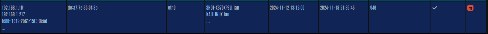

Here's another example - SHDT-Z370XPSLI should be my desktop, which I'm on right now - pic 2 for the device's IP info - but it also seems to have KALILINUX. That's a VM that hasn't been online in over a month.

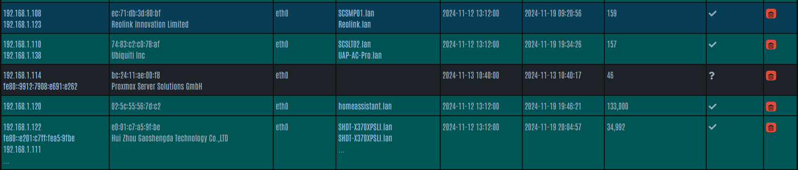

And here's some more examples of simply confusing naming. There are two MORE SHDTs in here (sure, probably for the LAN port - above was WiFi) as well as SCSLT02 (hasn't been online here in ~3 months) which seems to be shared by my Ubnt AP.
