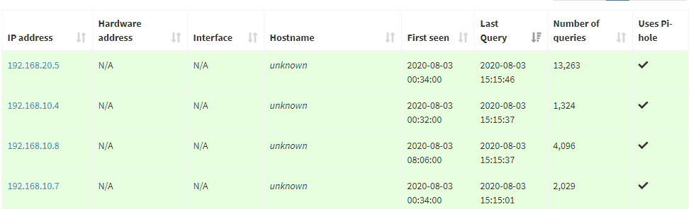

Network Overview entries missing MAC, interface and hostname
Under Network Overview, I would have expected the hosts on my network to show their MAC address, their interface and hostname. I am using a pfSense installation that hands out DHCP to clients.
All clients have static DHCP reservations, and most of them include a hostname.
My clients are distributed over three VLANs:
  • VLAN1 (management) - where the network equipment lives, including firewall and pi-hole
  • VLAN10 (Trusted) - where our usual network devices live (laptop, tablet, smartphone)
  • VLAN20 (IOT) - where our IoT stuff lives (TV, thermostat, ereaders, Sonos, PV installation, etc.)
    All VLANs have internet using pi-hole. I can see that filtering works fine and ads are blocked over all 3 VLANs.
In pi-hole settings, I have the following configured:
DNS: upstream DNS server being 192.168.1.1 (my pfSense box)
Listen only on interface eth0
The 3 checkboxes under Advanced Configuration are turned off.
I have enabled conditional forwarding with the following settings:
  • Local network 192.168.0.0/16
  • Router: 192.168.1.1
  • Local domain name: empty

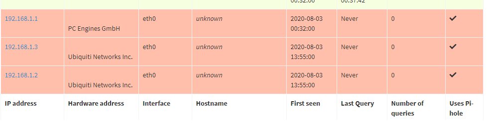

The situation in practice is that neither the MAC address, the interface as well as hostname is parsed to pi-hole. Strange side-effect is that VLAN1 does seem to expose details, that are picked up by pi-hole. How can I have the other VLANs transfer this information over?
With your setup, you won't be able to see the correct hardware address, but showing the right hostnames should be possible.
With regard to MAC addresses, what you see is the result of deploying VLANs in your network.
MAC addresses are link-local, i.e only visible to devices on he same network segment (aka link). By creating a VLAN, you define traffic on certain interfaces (commonly labeled ports on your router or switch) to define such a segment.
MAC addresses in one VLAN are ony visible in that VLAN, but not in any other. Hence, Pi-hole only knows about directly connected MAC addresses in your VLAN1.
IP addresses are of course visible network wide, but any inter VLAN communication has to be routed through a gateway.
