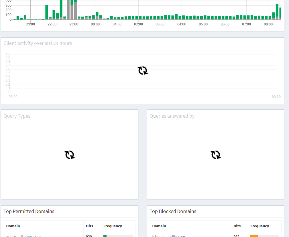

There is no traffic going to the wifi/outside world. However, pihole-FTL can retrieve the DNSs.
The same with chromium. It cannot connect anywhere. So many issues to be fixed... :sweat_smile:

Will need to reboot first to get dnsmasq running again.
pstree -s $(pidof dnsmasq)
Thanks for the long explanation :wink:
You are right in your assumption:
pi@raspberrypi:~ $ pstree -s $(pidof dnsmasq)
systemd───NetworkManager───dnsmasq
For some reason I cannot see the queries. Is that ok?
