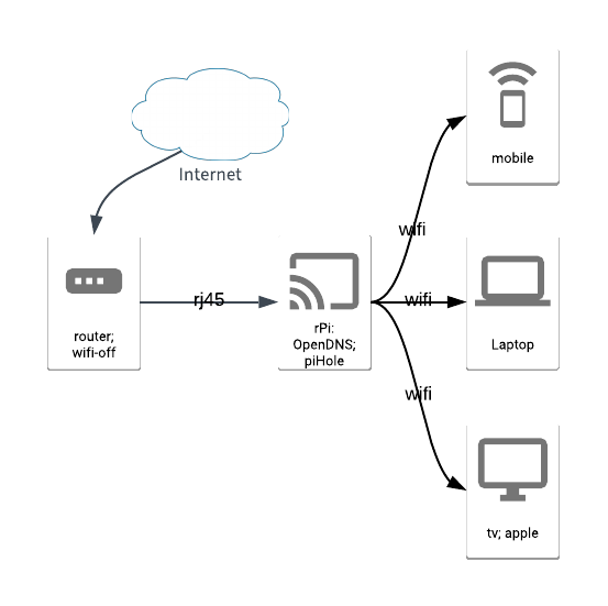

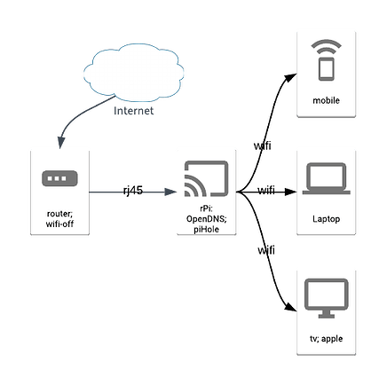

I was thinking implement something like this:
Dont know if this make sense.
In theory, this will work only if you make the Pi an access point, however a few things will be problematic:
  1. Pi has limited horsepower (i.e. cpu & wifi transmit) to service multiple clients. You may have favourable results with two to four clients, but as the numbers grow, you may start having disconnections.
  2. The wifi broadcast of Pi will be much lower than the orginal wifi router. This will translate to a lower signal. As well, you need a high gain antenna to have a usable range.
  3. Additional software will be required and configuration of setting up a routable Pi access point. You can find this here: https://www.raspberrypi.org/documentation/configuration/wireless/access-point-routed.md
  4. Pi does not have a heatsink on it's cpu (at least the one I have does not). When the cpu becomes heavily utilised, this will translate as heat. If you don't cool it then thermal shutdown will occur.
It might be worth the hassle to find a good cheap router rather than put yourself thru this battle.

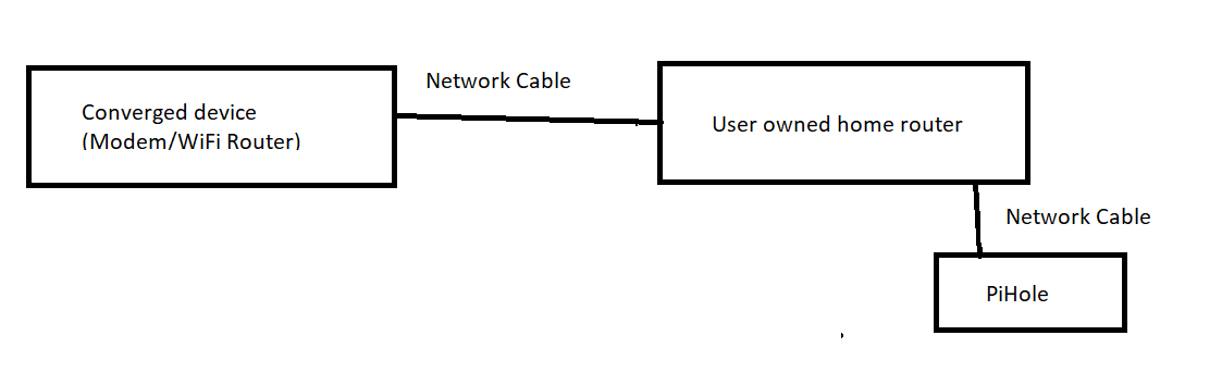

Alternatively, you can keep the proprietary wifi router as your main wifi, disable DHCP on it, point it's DNS to your Pi (which is configured as router), i.e. ensure you have followed the link I gave above (Note: Pi is now a DNS, DHCP & router but you can skip the access point configuration). In effect you now have an open source homebuilt router, but still using the service provider's wifi. Note that they can look at your wireless clients, this is why I prefer a separate user owned router in between.
Option 1: Configure your router to use your pihole as DNS. Not always possible, particularly with ISP provided router.
Option 2: Configure your pihole to serve DHCP.
