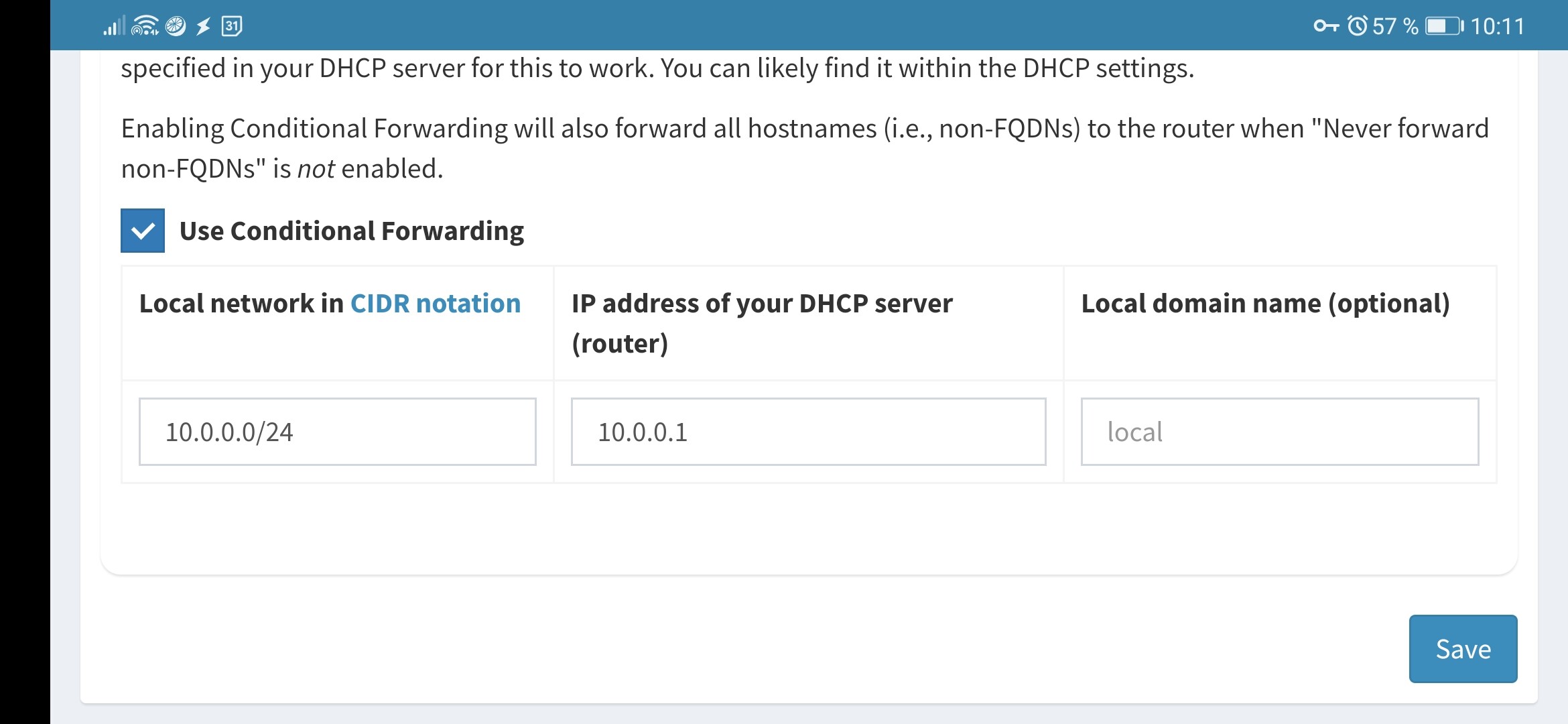

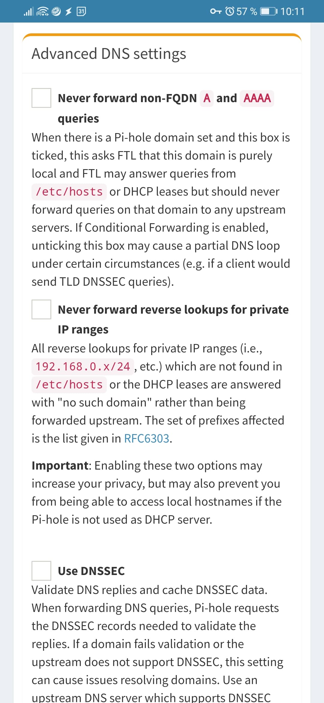

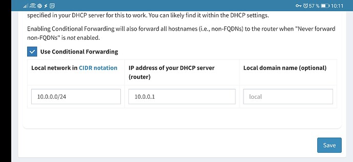

One RPI zero running pihole, wired connection to MR60. Conditional Formatting enabled.

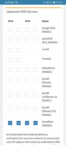

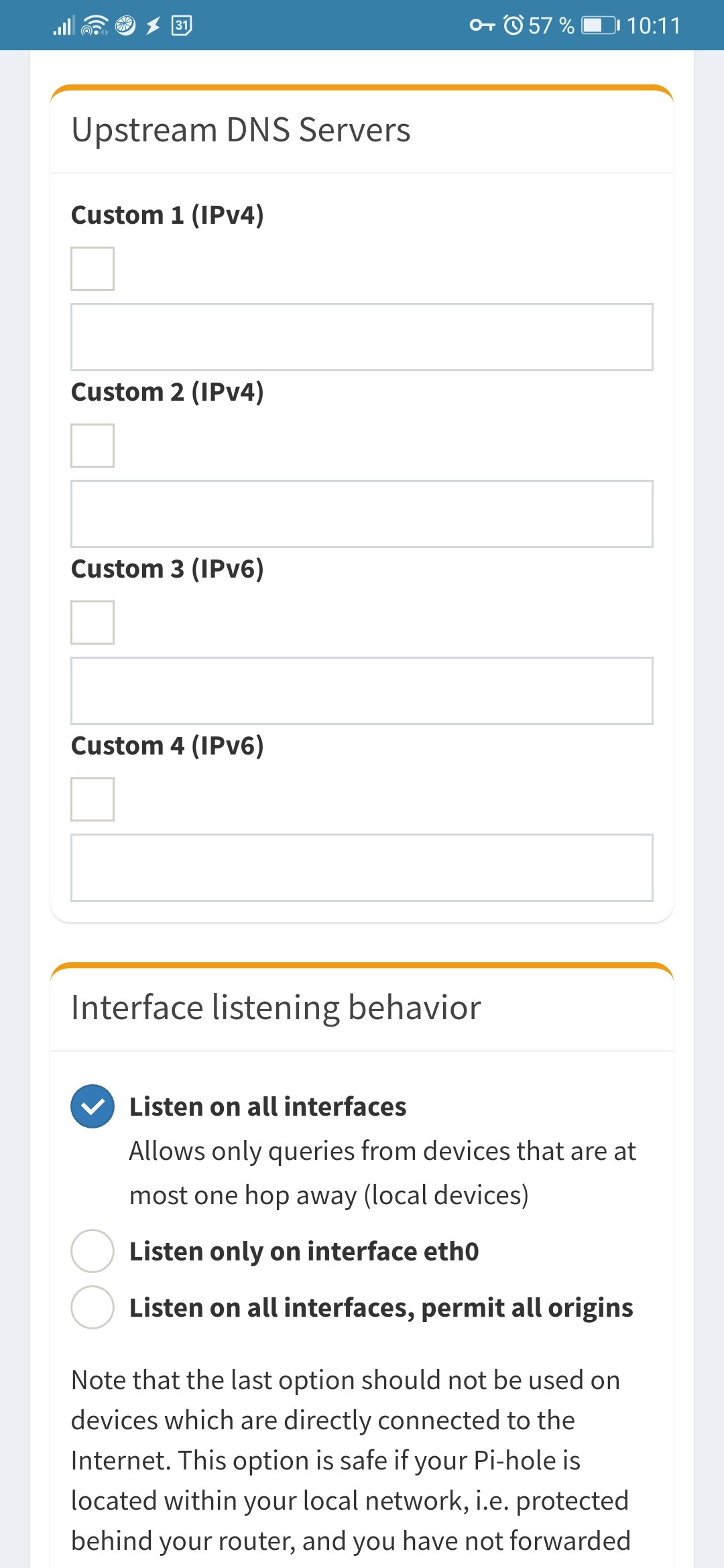

I want to see the individual IP addresses in the query logs.
The pihole only shows the IP address of the MR60 in the logs (except for when I'm connection to the RPiZ via WireGuard of course.
I've been trying to setup the pihole and MR60 so that the MR60 will show the pihole the individual IP addresses, but I'm not succeeding.

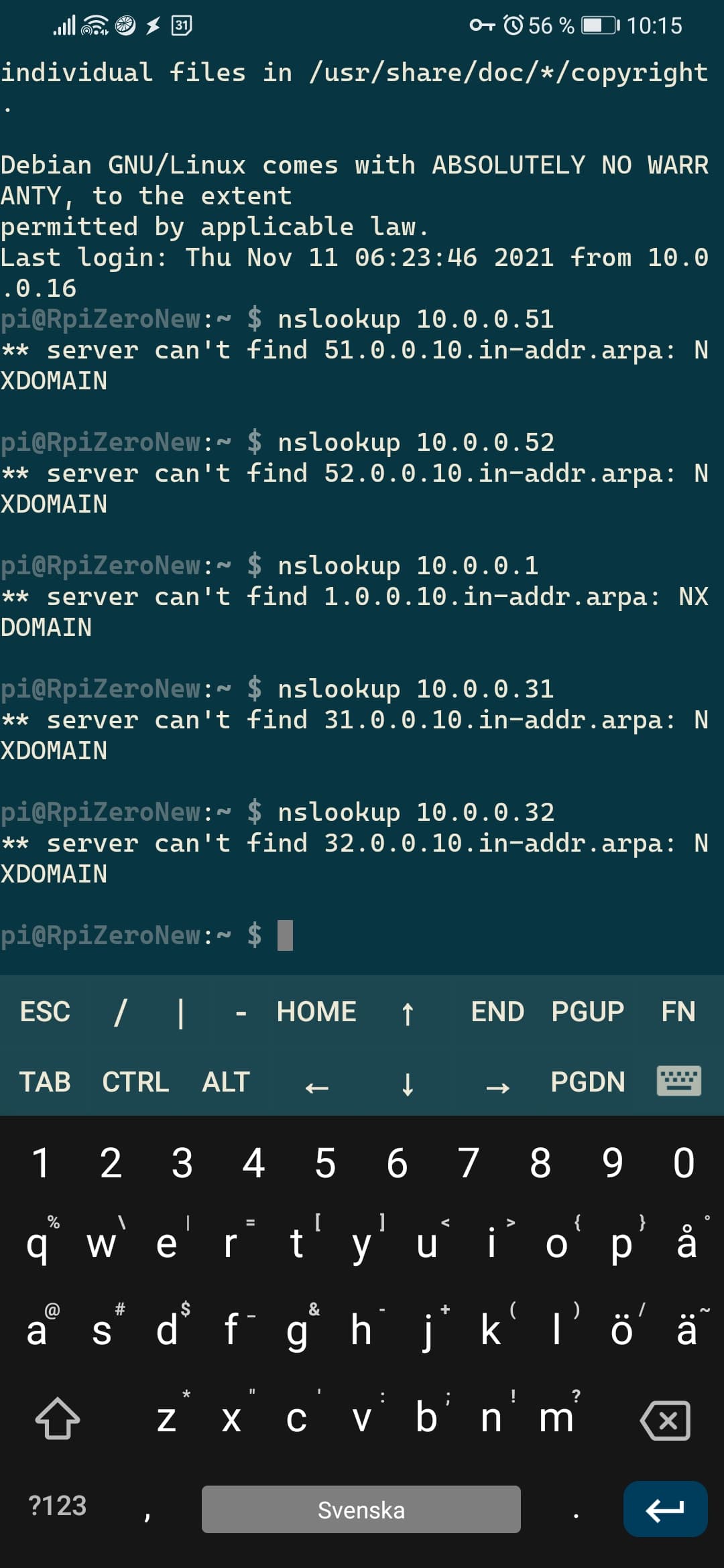

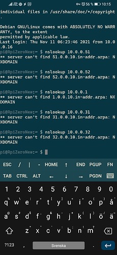

And the nslookup on the RPiZ looks like this for several known devices;
https://tricorder.pi-hole.net/24lRTh24/

Conditional Forwarding has no bearing on this - it would only allow you to associate hostnames as known by your router to IP addresses as seen by Pi-hole. And Pi-hole currently just sees your router's IP.
