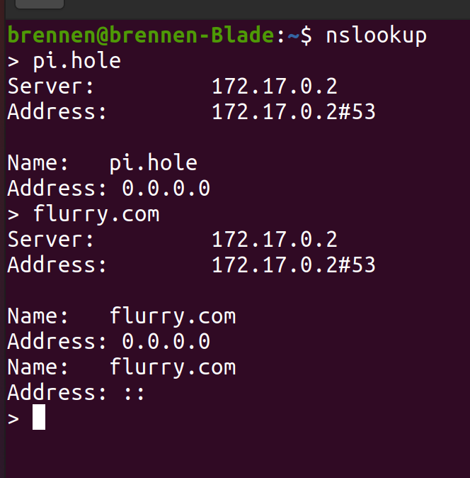

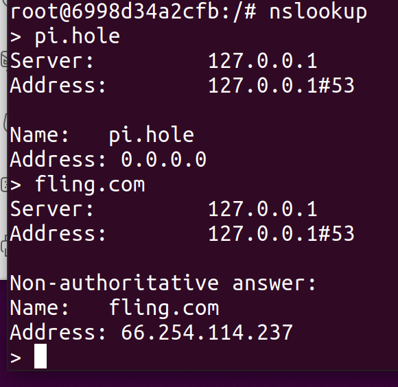

An image of the output from the commands should be attached.

Those lookups seem to be run from your Pi-hole host.
Please run them from a client, as requested.

Sorry about that, I'm not super familiar with all of this. Just trying to figure it out haha. Though I believe this has shown (at least a portion of) my problem.
Your above nslookup results show that the client you've run it on is using Pi-hole for DNS for this request (as only Pi-hole knows to resolve pi.hole), and it also shows that Pi-hole is blocking flurry.com as expected.
However, the 172.17.0.2 IPv4 address of your server running Pi-hole is the Docker internal IP of Pi-hole's container.
Normally, Docker would strictly isolate that address from being accessible outside of Docker, i.e. your client should not have been able to contact Pi-hole using that 172.17.0.2 at all.
