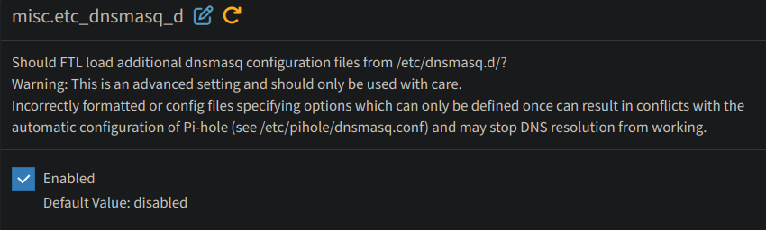

@jhmc93 the guide isn't very complete and makes confusing remarks in my humble opinion. It works, but explains very little and leaves some guess work.
First make sure you edit the /etc/dnsmasq.d/07-pxe.conf
file and replace 192.168.1.YOURSERVER
with the appropriate IP address of the host running netboot.xyz
. If this is running in Docker, it would be the IP address of the host running Docker, not the IP address assigned to the container. Just sayin' .

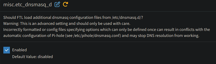

Next, go into Pihole WebGUI, and goto Settings in the left menu, then choose All Settings, and enable top right slider to All Settings (it will show green).
Then on the Horizontal TAB bar, open Miscellaneous. Look down to where this is:
Make sure it is Enabled. Without it, it will not load your new file 07-pxe.conf
you placed in /etc/dnsmasq.d
