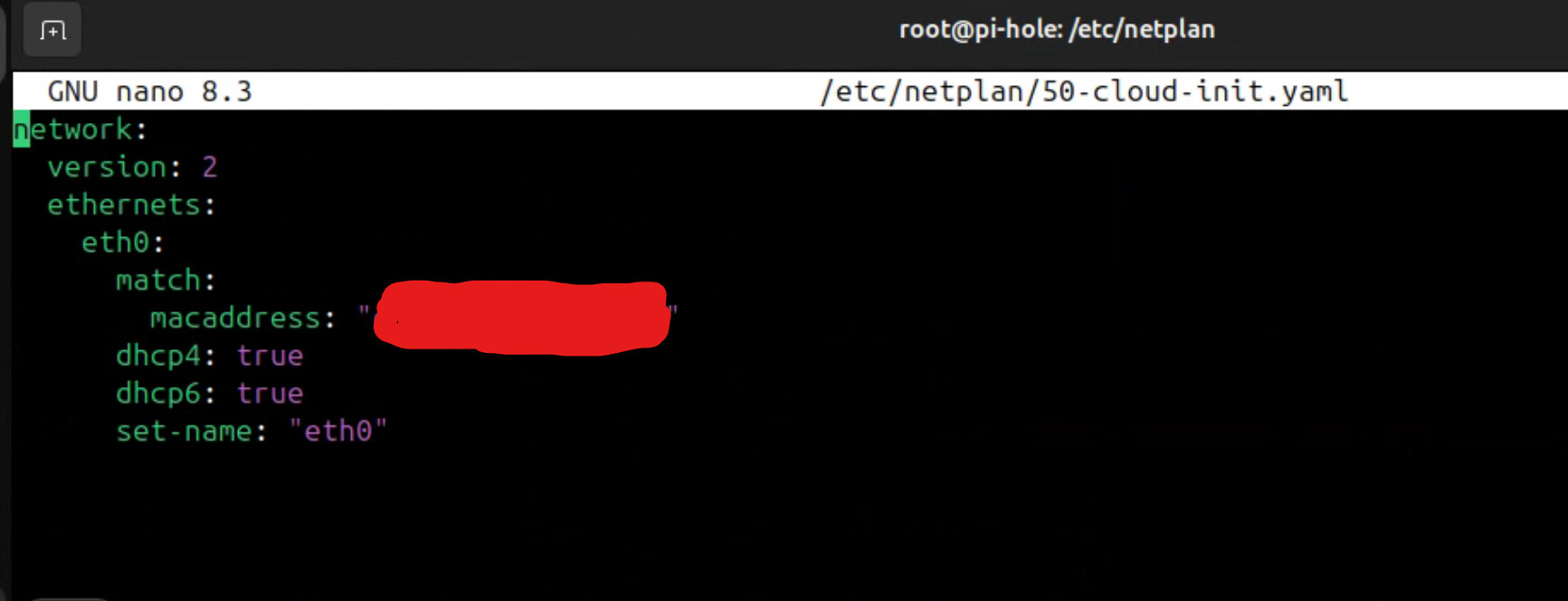

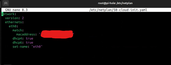

I am still having issues with configuring it though, again networking and linux noob!
This is what my netplan yaml file looks like:
I’m not finding anything good on the internet explaining how to configure the one for Ubuntu Desktop 25.04 - I do see some similar ones like this:

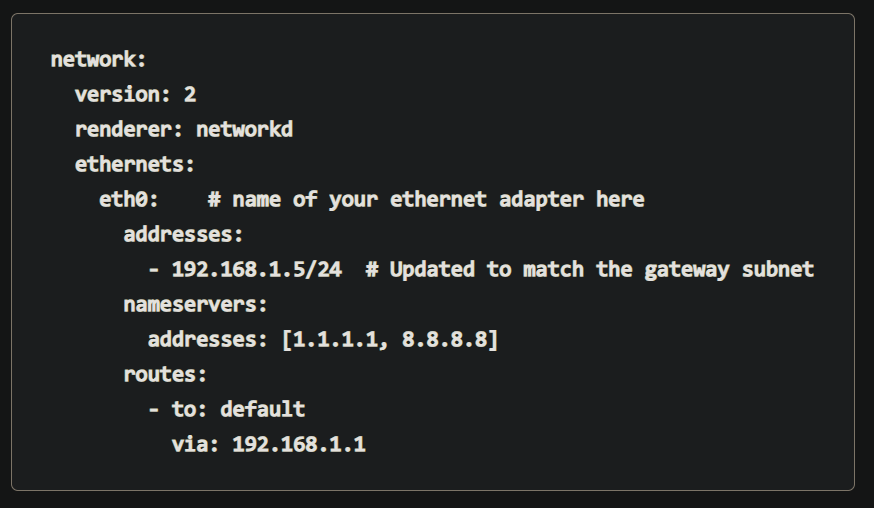

I’m thinking of just copy and pasting this into my yaml file, but a couple questions:
For addresses, I’d just be doing 192.168.1.200/24 correct?
For nameservers, I’m a little confused, do I add an external DNS provider or do I just point it back at itself, so something like [192.168.1.200, 192.168.1.200]
For routers, I’m not exactly sure what to do here, just leave to: default and via: 192.168.1.1? That would be my routers address.
Usually, the best practice is to use external/public DNS servers for the machine hosting Pi-hole.
I’m not running Ubuntu myself, but yes you specify your 192.168.1.200/24 under eth0: “addresses:” for the Pihole static IP.
As for your original config, I would think you’d want dhcp4 and dhcp6 to be “no” (or not specified, not sure of the syntax) since you don’t want to use DHCP to get an address for this device.
Looking back at the Google AI answer, it would support my assumption that you have something like this:’
network:
  ethernets:
    eth0:
      addresses:
        -  192.168.1.200/24
      gateway4: 192.168.1.1
      nameservers:
        addresses:
           - 8.8.8.8
           - 1.1.1.1 #enter your choice of one or more public DNS servers here
      dhcp4: no
    version: 2
Not all of that may be necessary, but it’s a start.
