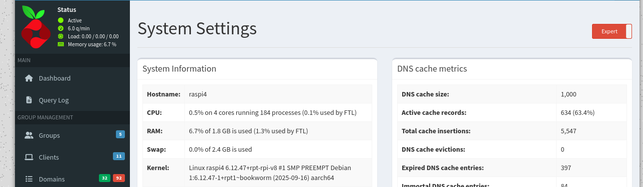

Click on "Basic" here:

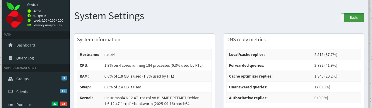

And it will change to "Expert":

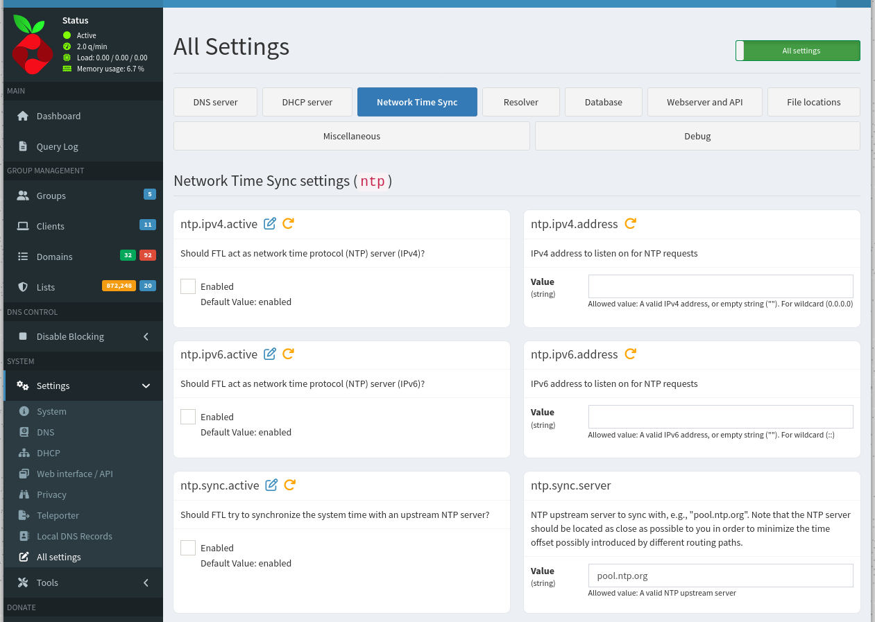

Then click on "All settings" in the left-hand menu, and then on the "Network Time Sync" tab:
If that doesn't work something is up, and you might want to try posting a debug token.
Thanks… that was the solution..
