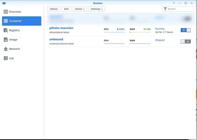

Need help with installing mvance/unbound and getting it to work with my currrent pi-hole on DSM 6.2
I currently have Pi-hole 6.1.4 installed and running on my NAS via a docker container and I would like to add Unbound to the mix. I tried using ChatGPT to help me but with a lot of trial and error couldn't get Unbound to work with my Pi-hole. I have Pi-hole running through a macvlan network and Unbound through a custom bridge network. What is the best way to approach this? I see some recommending to have both pihole/unbound on the same macvlan network, and others saying to heave pihole on a macvlan and unbound on a custom bridge. There's so many conflicting info out there that I don't know which would be best for me. Need some good advice here.
Please tell me what I'm doing wrong and exactly what I need to change or fix to get it working.
Here's a breakdown of my current setup
  1. Synology NAS 1512+ (Running DSM 6.2) with an IP of 192.168.68.21
  2. Pi-hole server IP is 192.168.68.75
  3. Gateway 192.168.68.1
  4. Subnet Mask 255.255.255.0
  5. Manually set Router's Primary DNS to 192.168.68.75

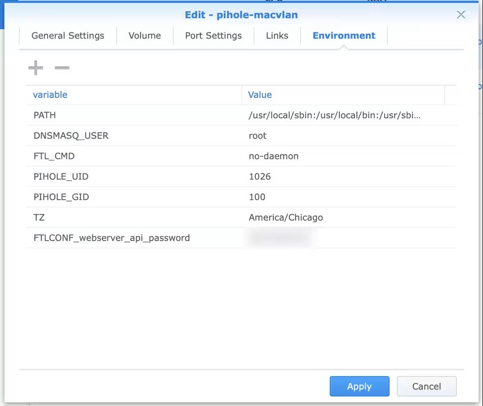

    environment:
      - PIHOLE_UID=1026 #CHANGE_TO_YOUR_UID
      - PIHOLE_GID=100 #CHANGE_TO_YOUR_GID
      - TZ=America/Chicago #Timezone
      - FTLCONF_webserver_api_password=password
      - DNSMASQ_USER=root #DSM 6.2 requires root

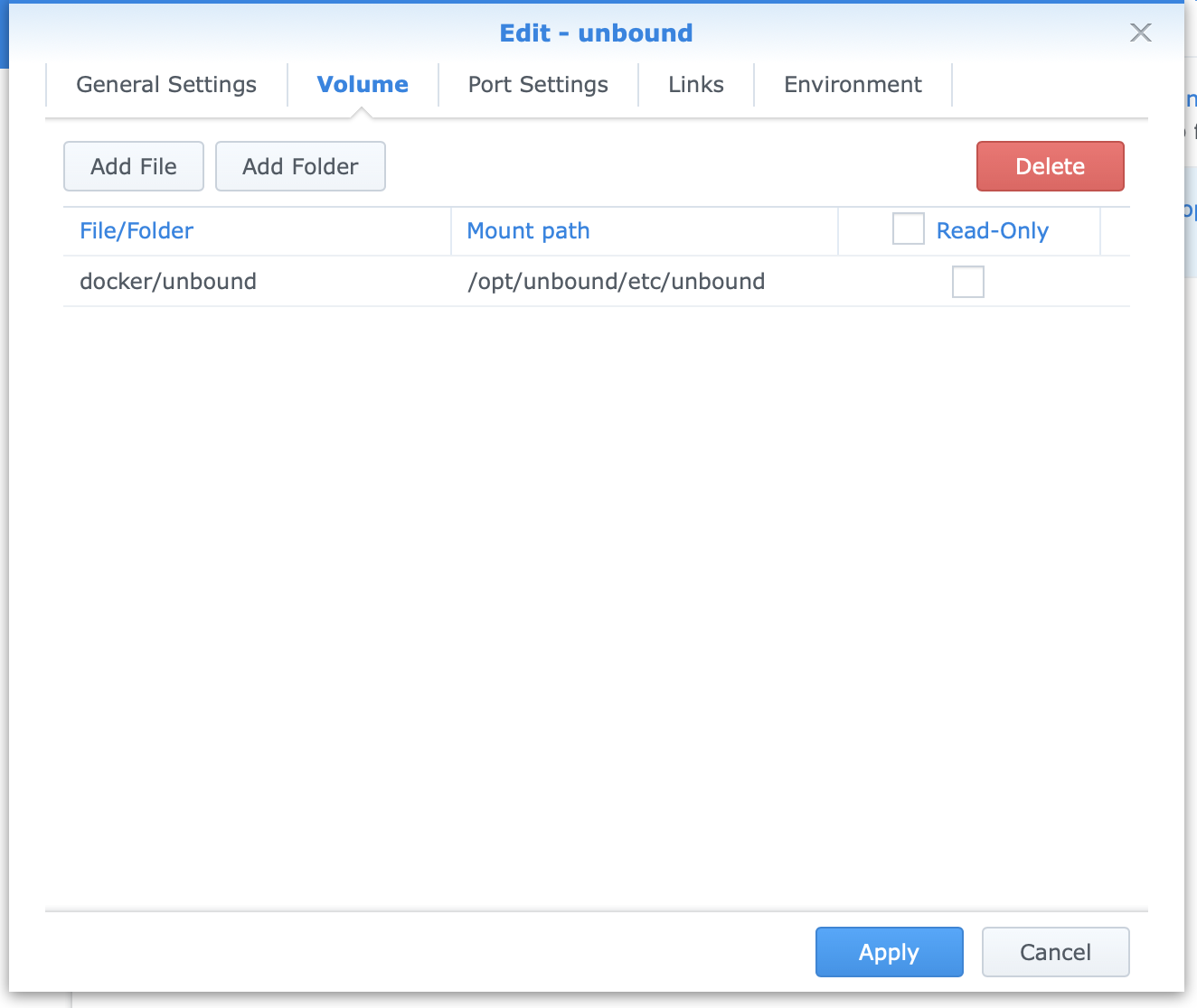

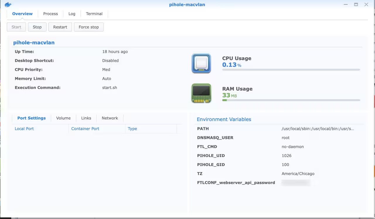

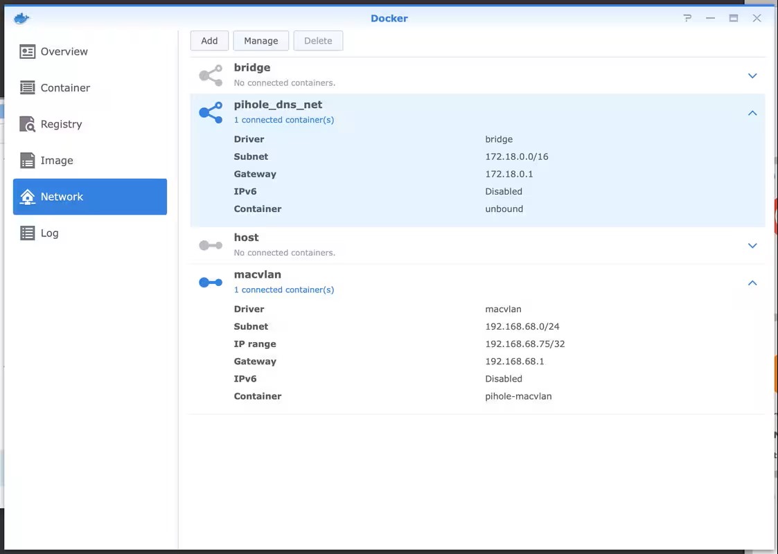

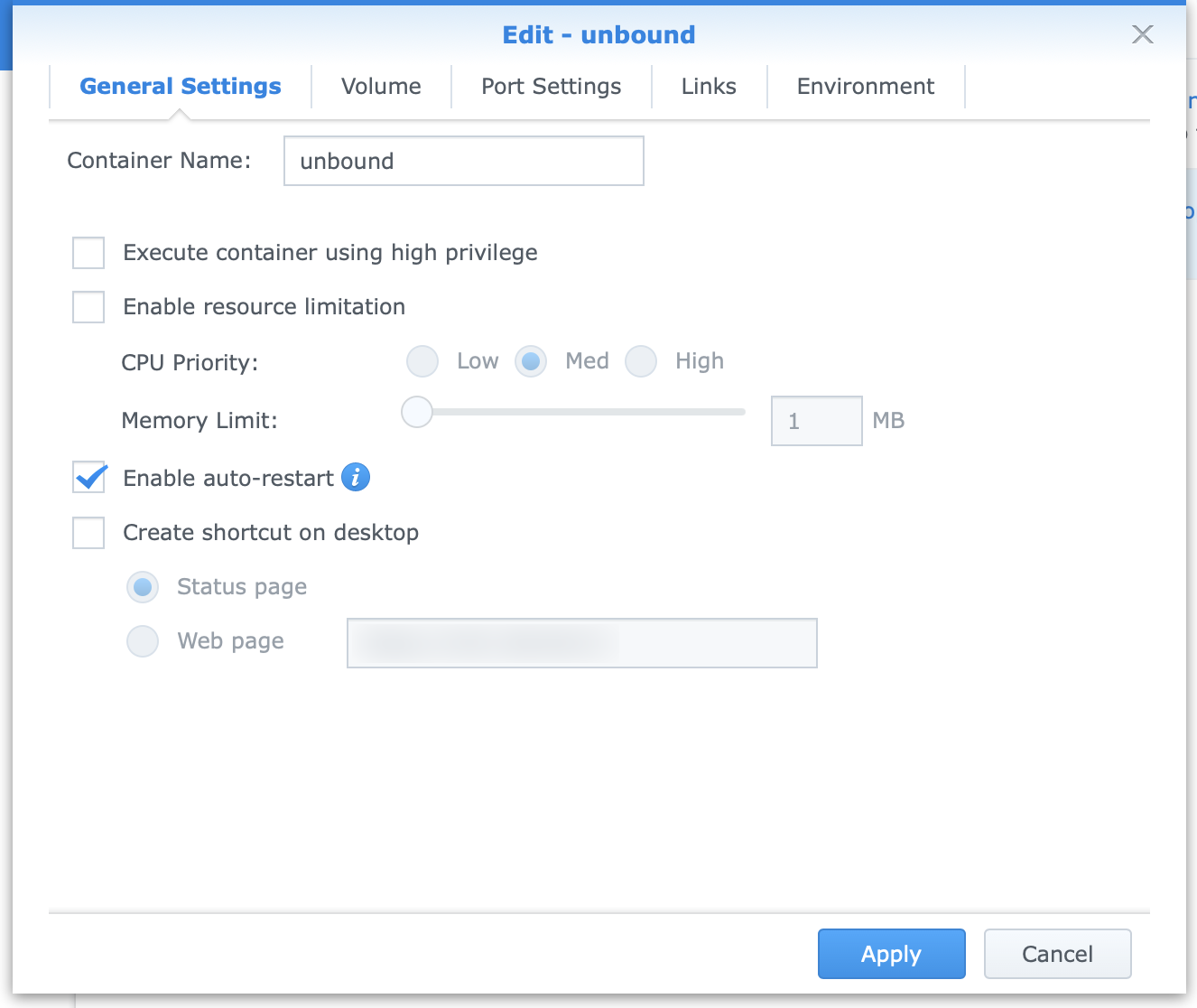

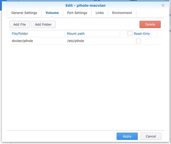

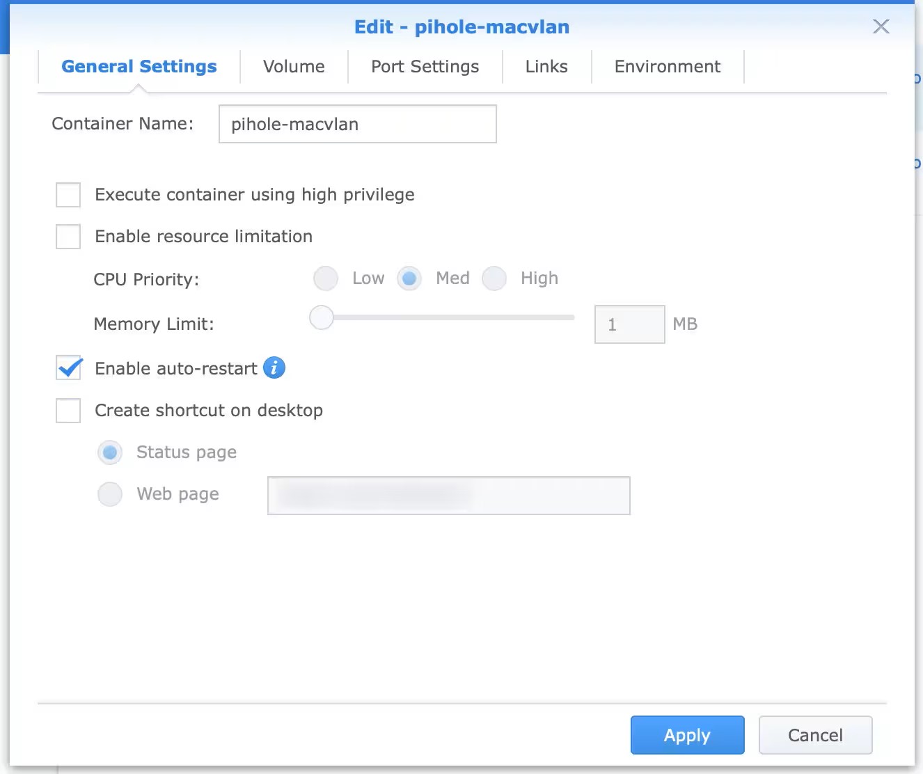

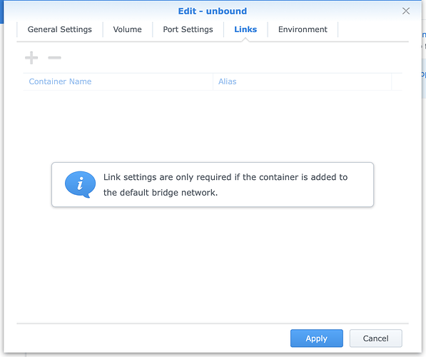

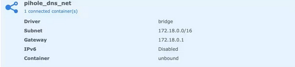

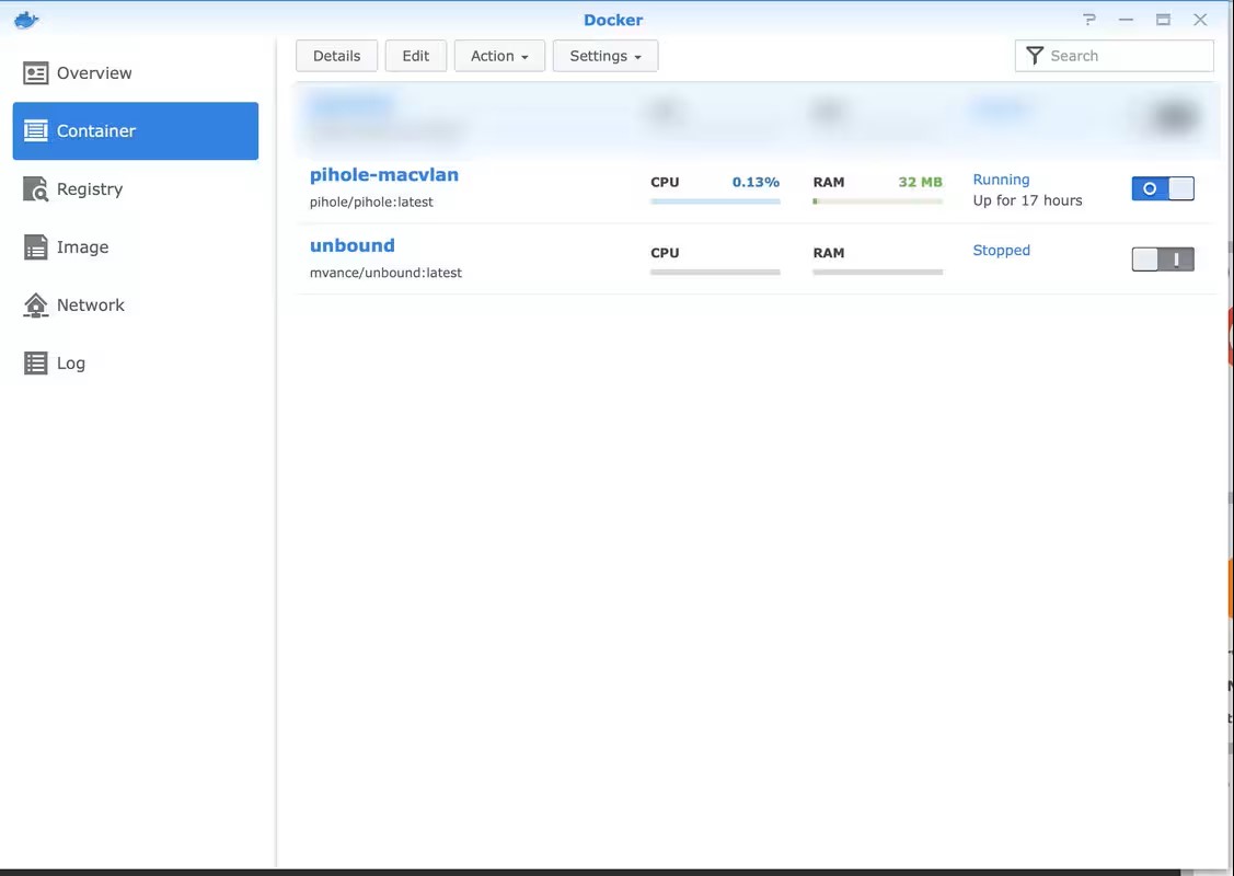

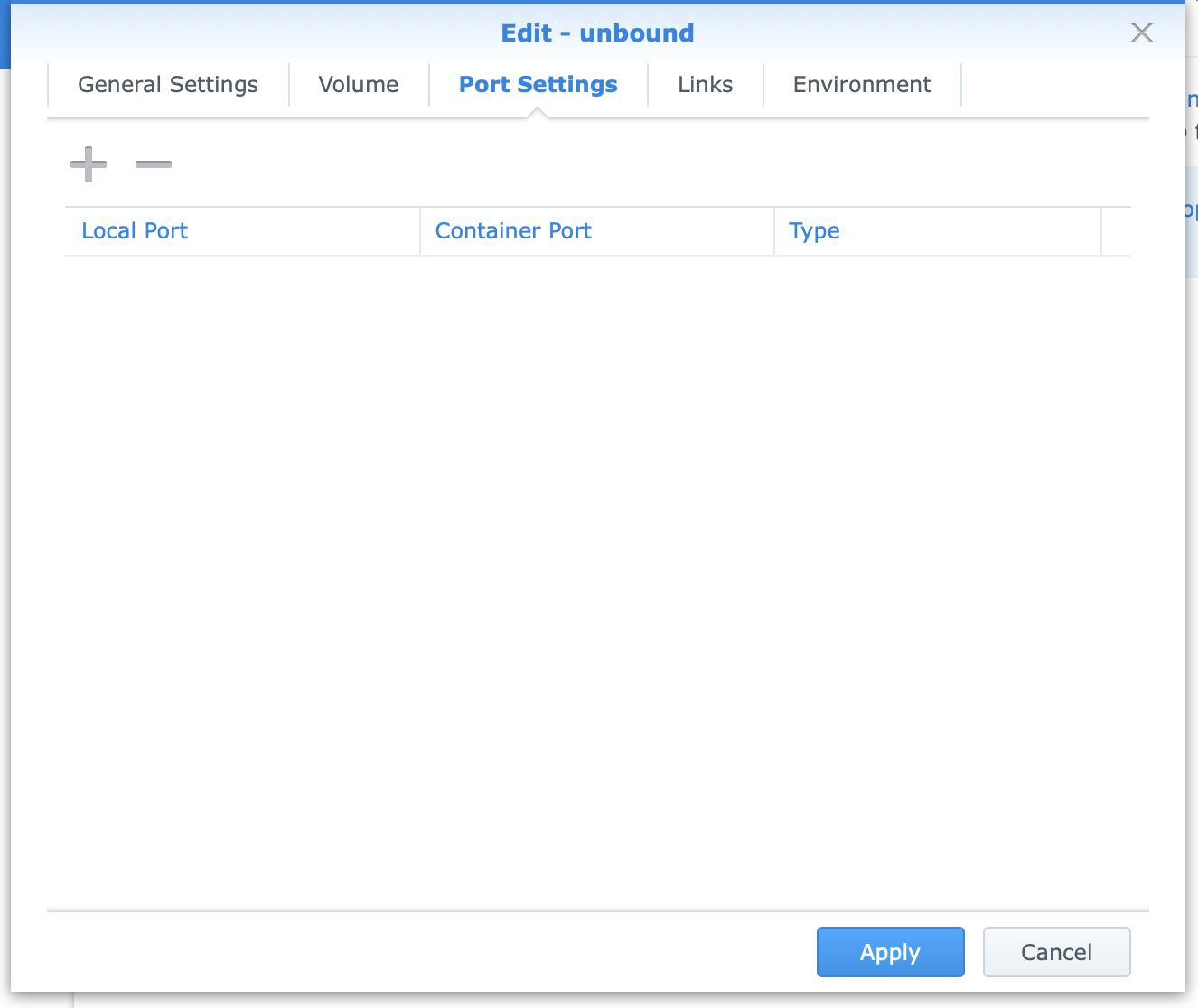

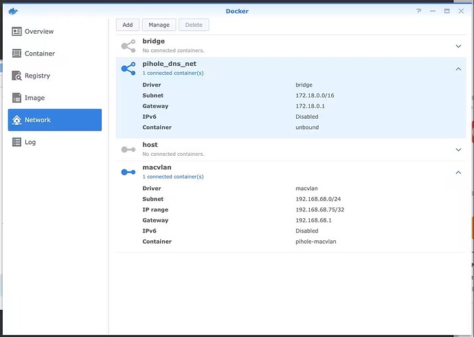

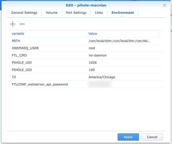

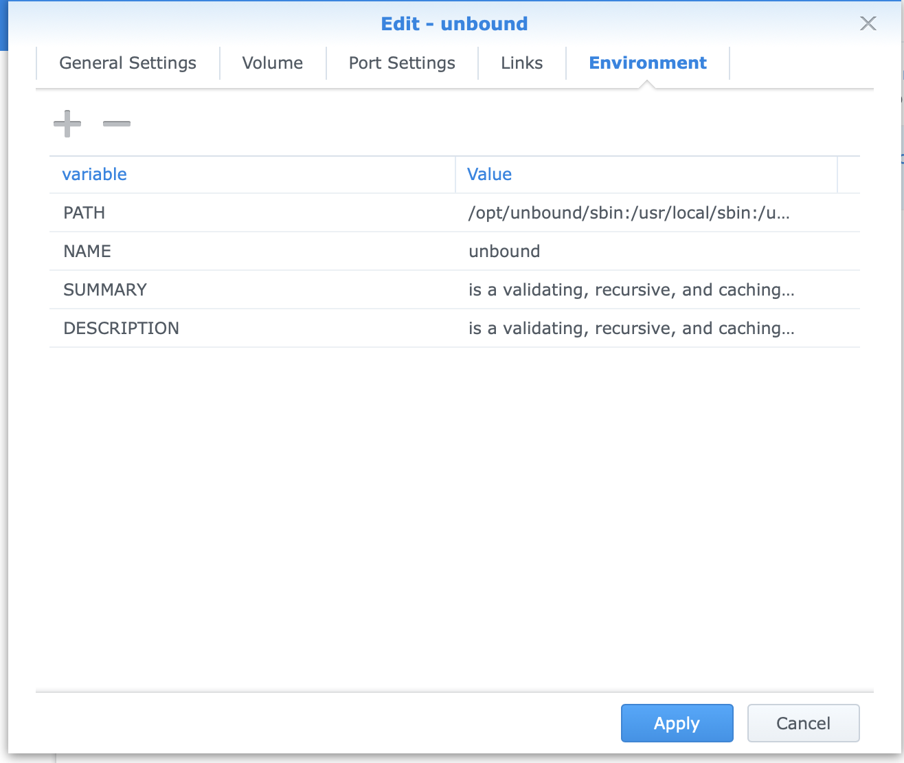

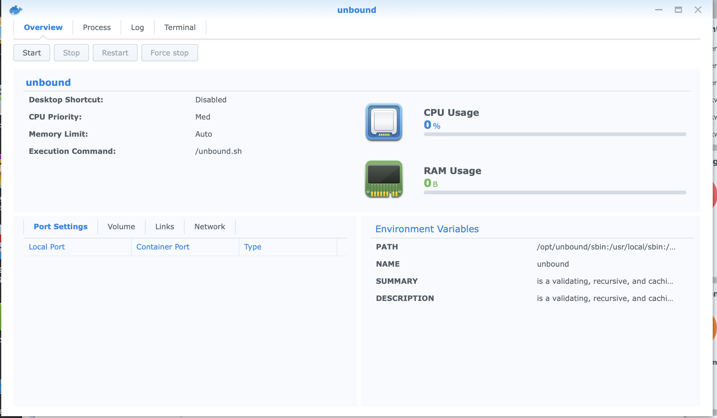

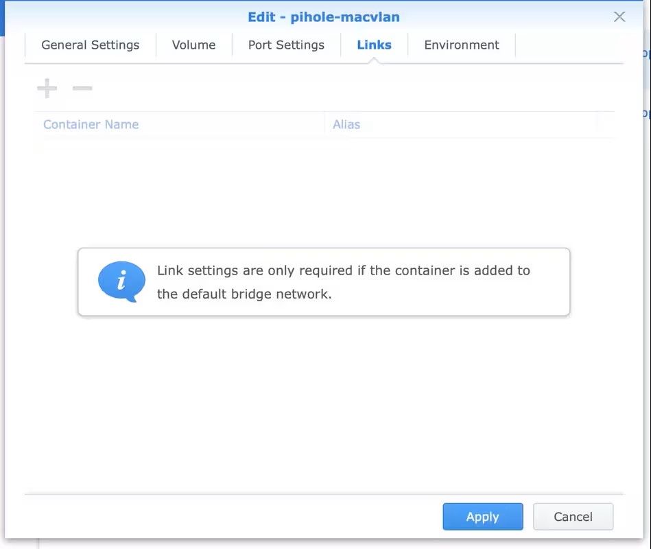

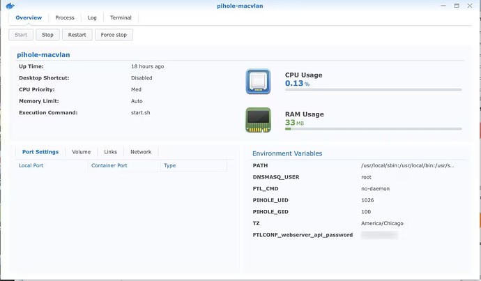

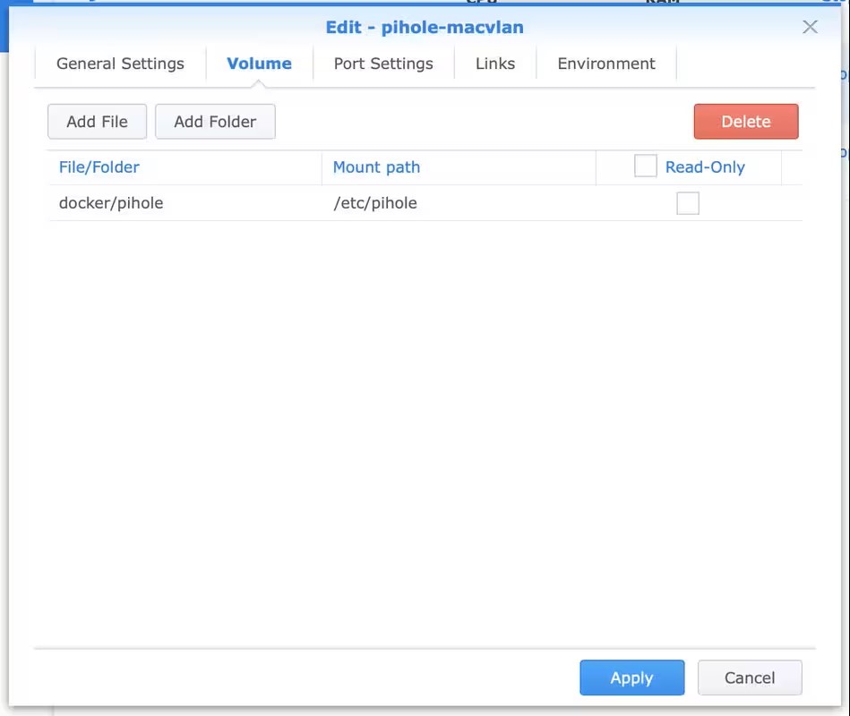

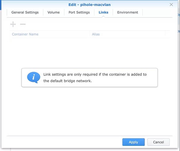

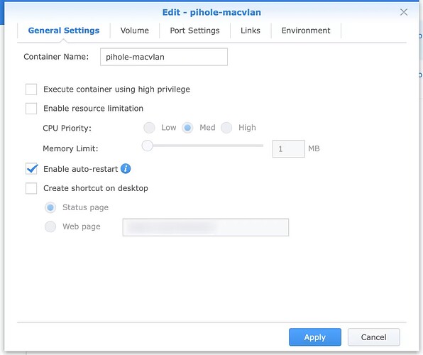

Docker Container & Docker Network Settings:
Docker Pi-hole Settings:
Pi-hole Settings:

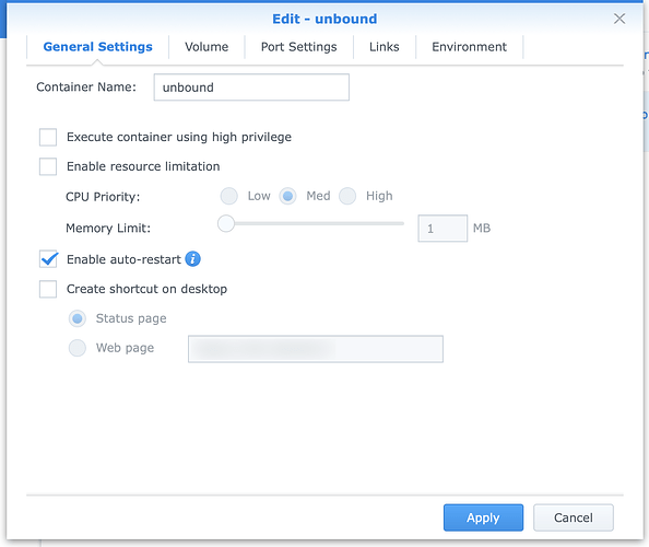

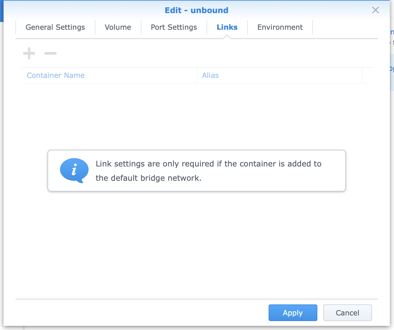

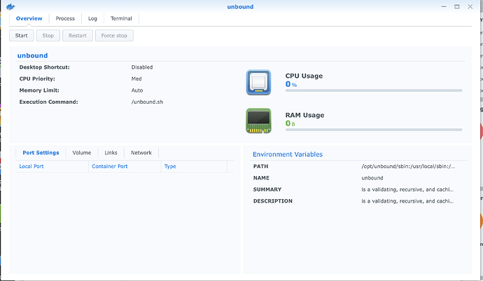

Docker Unbound Settings:

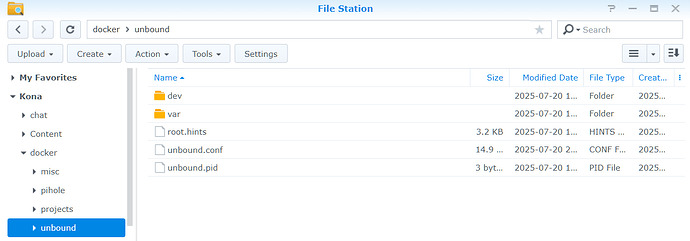

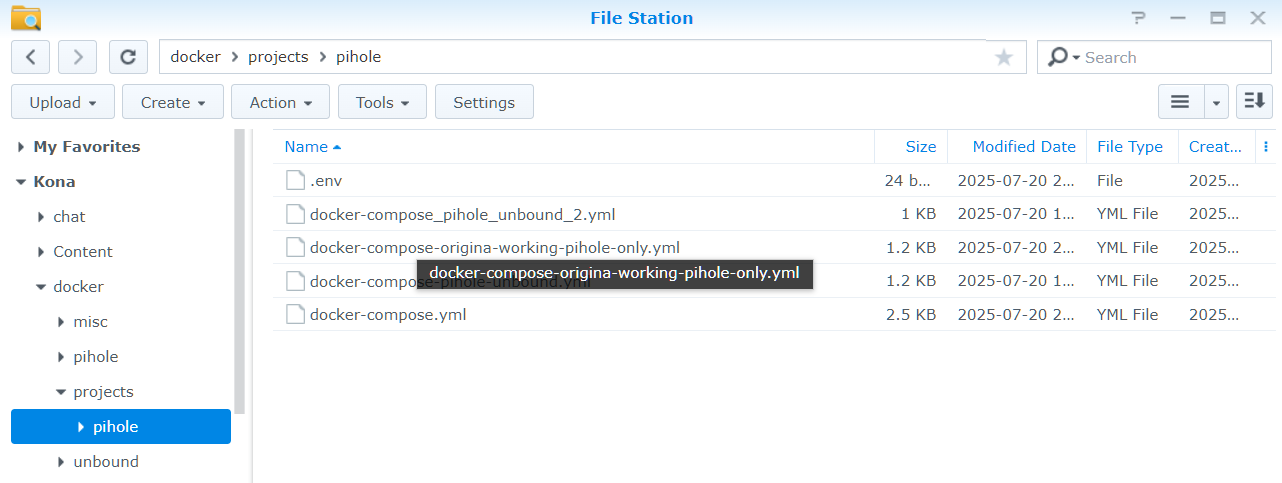

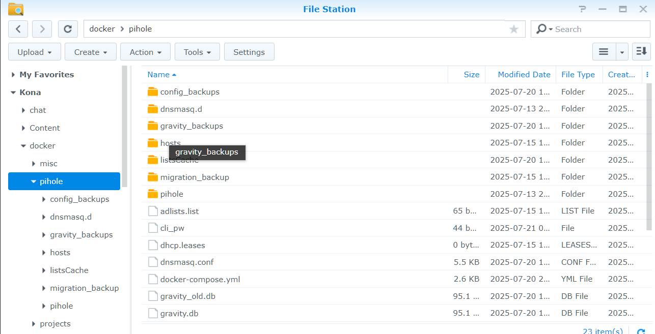

Folder structure:

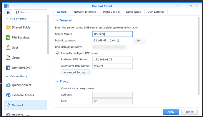

DSM > Network > General Settings
Unbound.conf

These don't seem to match in terms of IP address:
Don't do this.
Despite the unhelpful labeling in some software, there is no such thing as a "Preferred" or "primary" vs "Alternativet" or "secondary" dns server. Devices make their own choice amongst all of the DNS servers provided to them.
Until your unbound cache is suitably populated, DNS via quad 9 will normally be faster, and most devices tend to favour the fastest of the DNS servers they have to choose from.
They are the two things that first jump out at me.
It might be handy to post the contents of your pihole settings (redact the password hash, and any other sensitive information present).
If you're able to get actual settings files for any of this (as you did with the unbound.conf and docker-compose) that would help anyone trying to work out what's up rather than screenshots.
I did post all my settings. Unless you're specifically asking for something else that I'm unaware of?
Could we start on a fresh new blank slate? My goal is to have Pi-hole and Unbound running on my NAS (DSM 6.2). Right now I just have Pi-hole running successfully. In order to add Unbound to the mix and get it to function properly, I'm willing to start all over if that'll make things easier.
