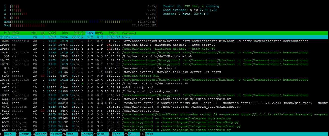

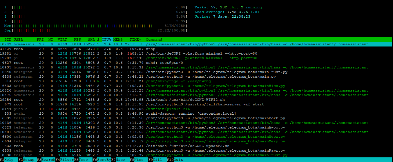

I've tried having the htop command open to see if any processes use a large amount of resources while the issue is happening, but I couldn't find anything.
Here's a screenshot of htop during an outtage, right before creating the debug log and while it's working fine. Not much seems to change when pihole has it's hickup.
