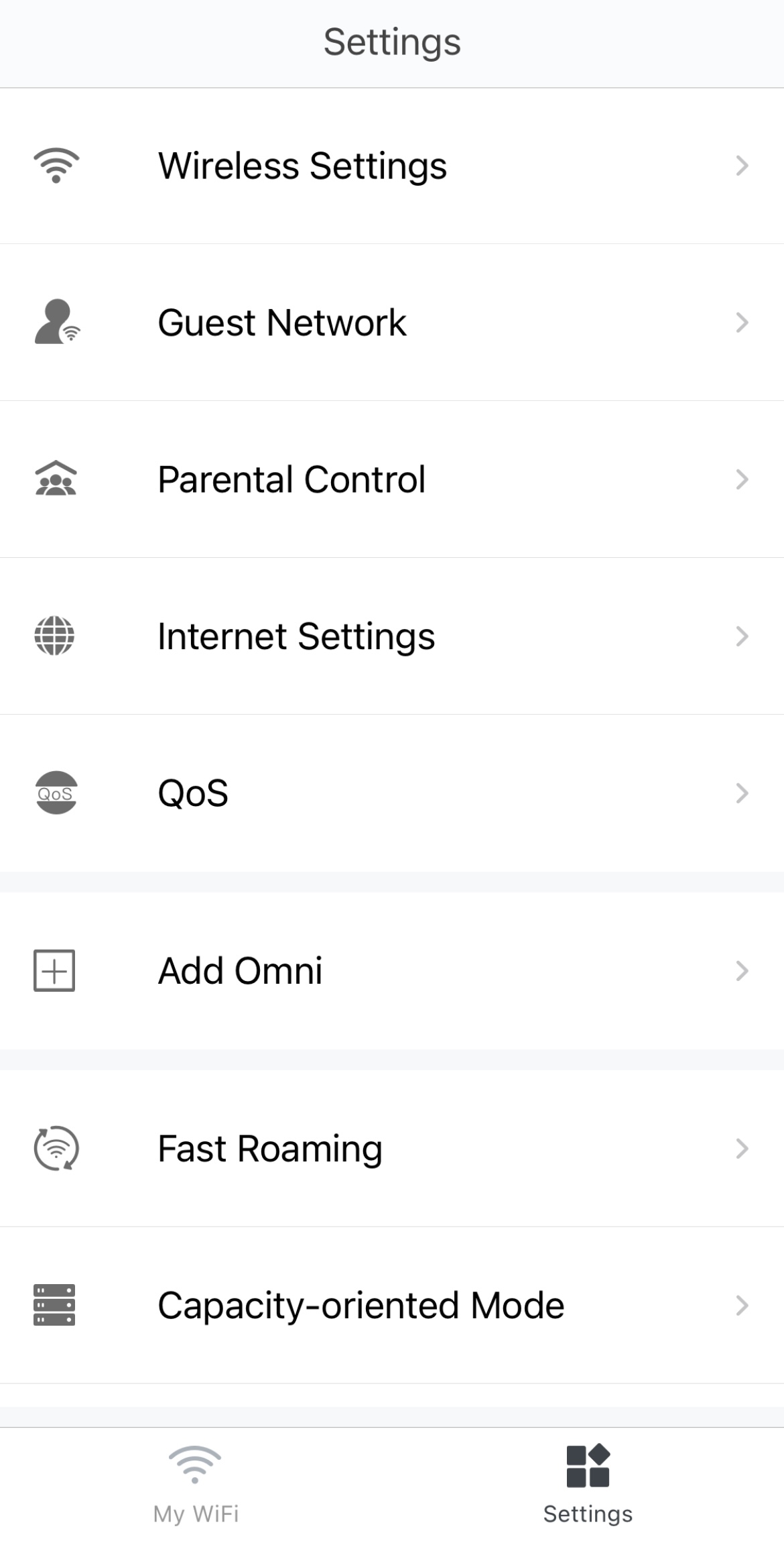

I’ve gone through the router app settings, there doesnt appear to be any tick box option to directly turn off dhcp, but there are a few other settings for manually tuning. Im not sure if it will work for disabling.
Theres the issue with if i configure it wrong i will not be able to revert the settings, because i will completely lose access to the router in the app when i lose connection and have to reset router, naturally..
If anyone here wish to give me some guidance and help me configure or validate if changing any of these settings to use pihole as dhcp will work.

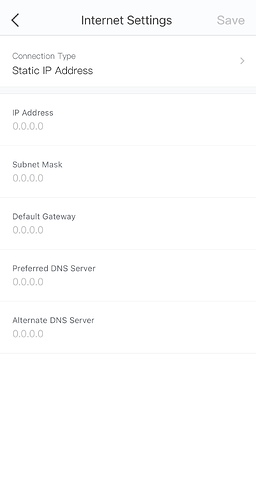

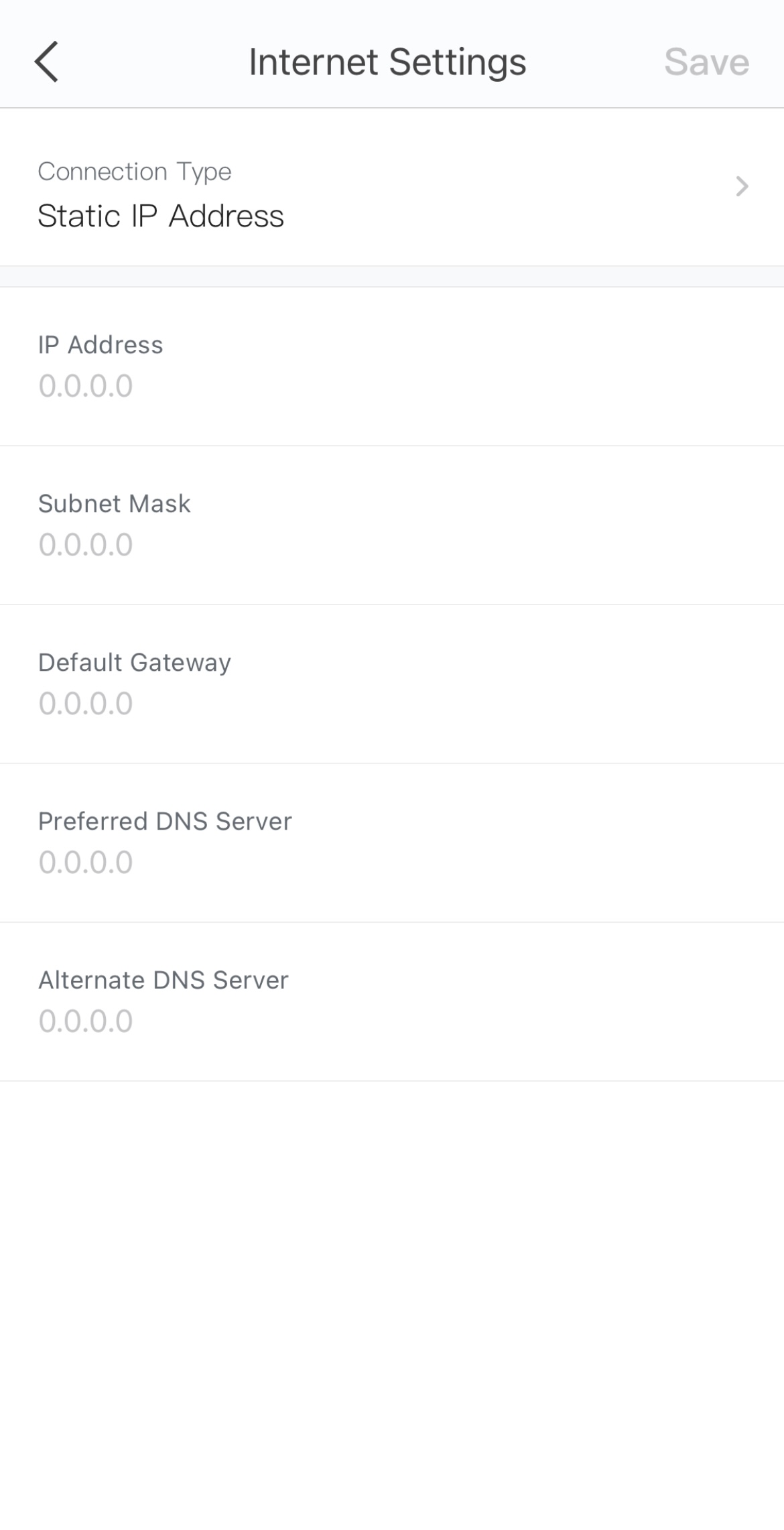

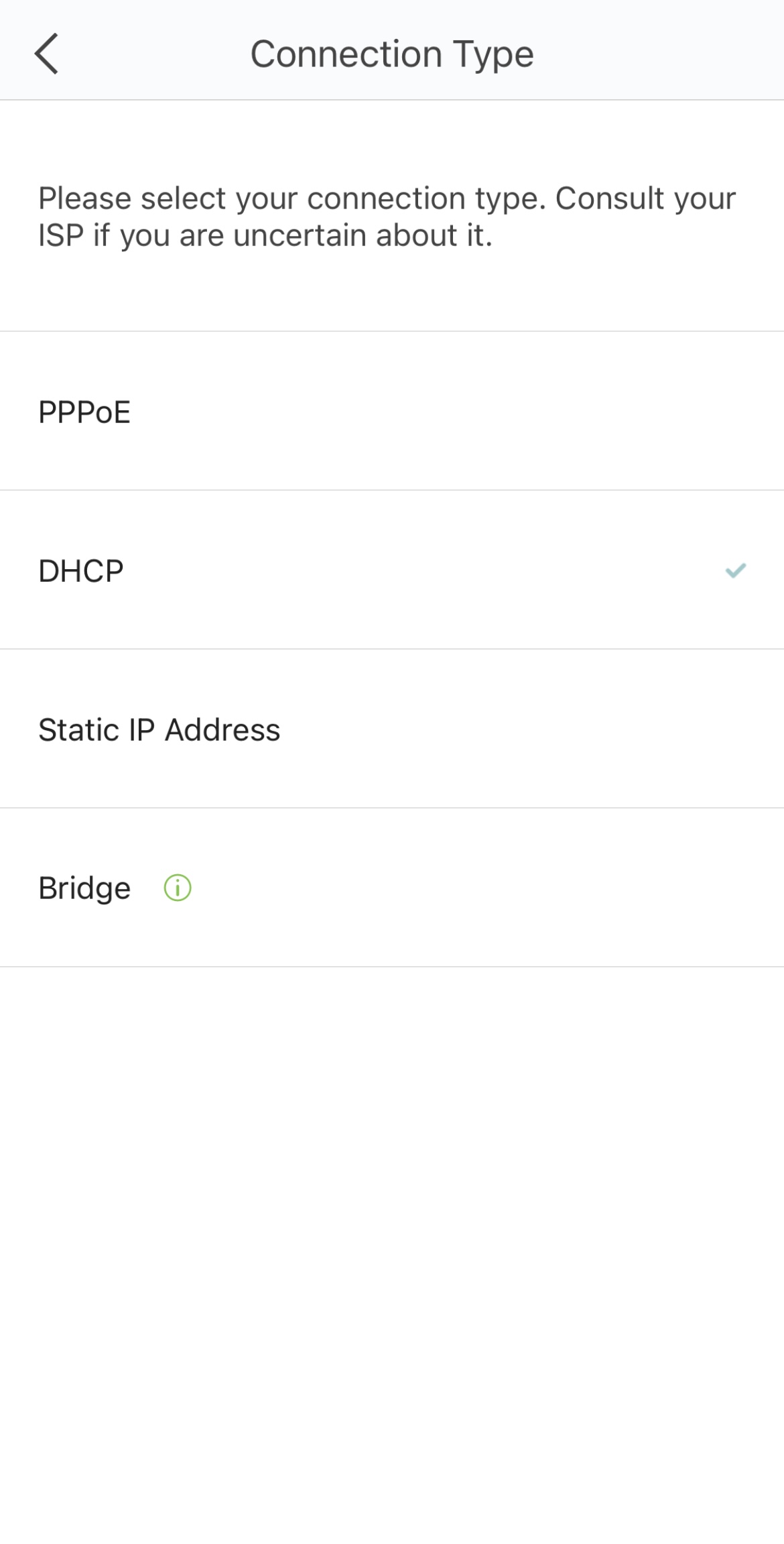

Theres an option for setting a static IP under internet settings from dhcp.

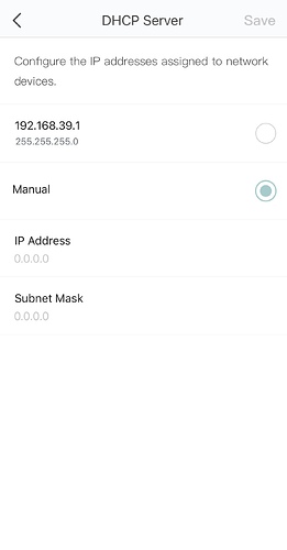

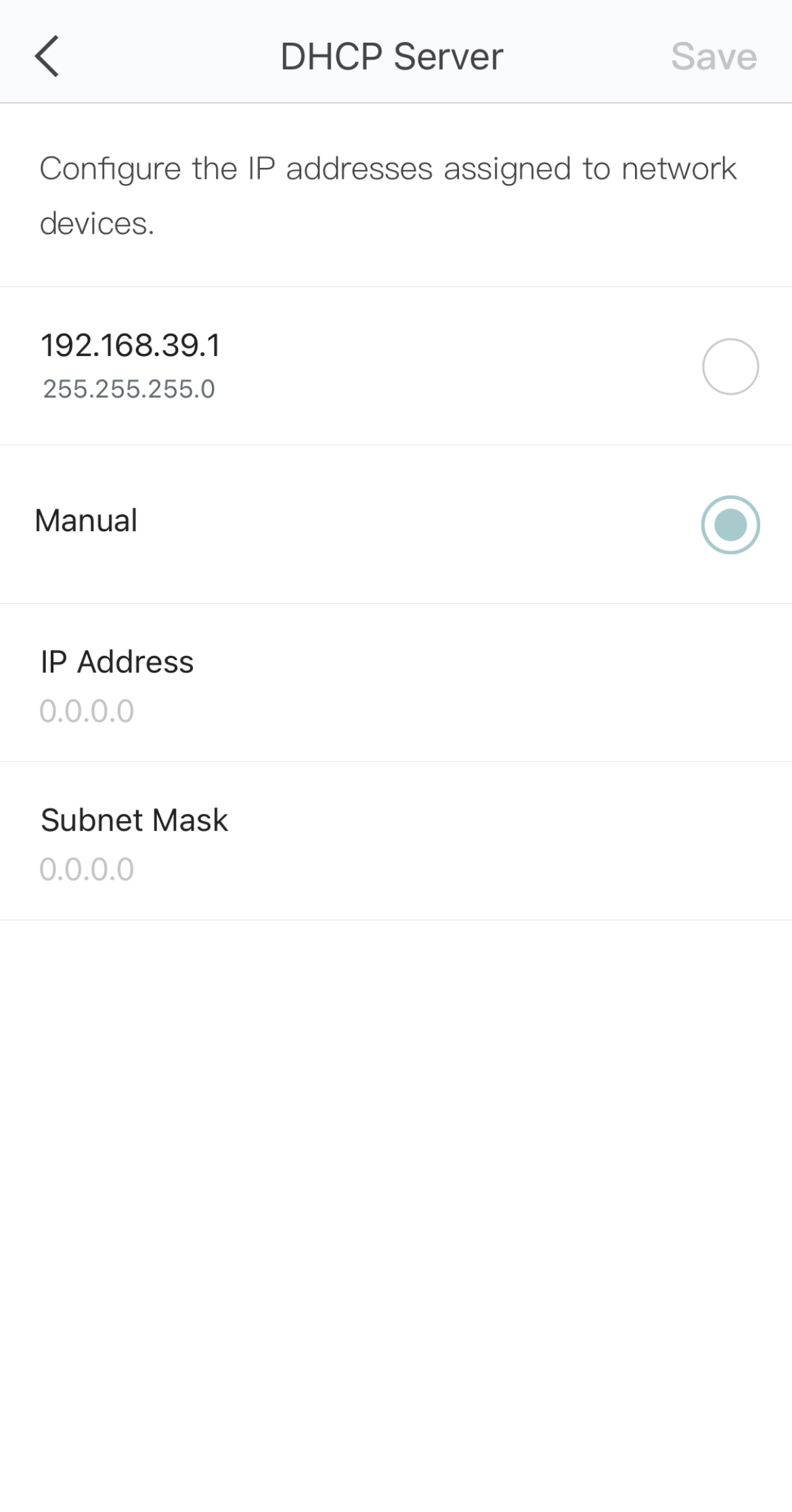

Then there’s the setting for dhcp server, but no off option here. I was thinking of pointing this to pihole’s address and in turn this would work of using that as the server instead, could this work?
If you could turn off the router's DHCP server and turn on the Pi-hole's DHCP server that would be the way I described. If you cannot turn off the router's DHCP server then the alternative approach is to tell the router's DHCP server to hand out the Pi-hole's address as DNS for the clients connecting.
The DHCP under Connection Type looks like the part related to the external IP address from your ISP. Don't change the Connection settings.
The later screenshot showing DHCP Server is your router handing out addresses on your network. That looks like the right section but there's nothing in there about the DNS to hand out so you can leave that as it is.

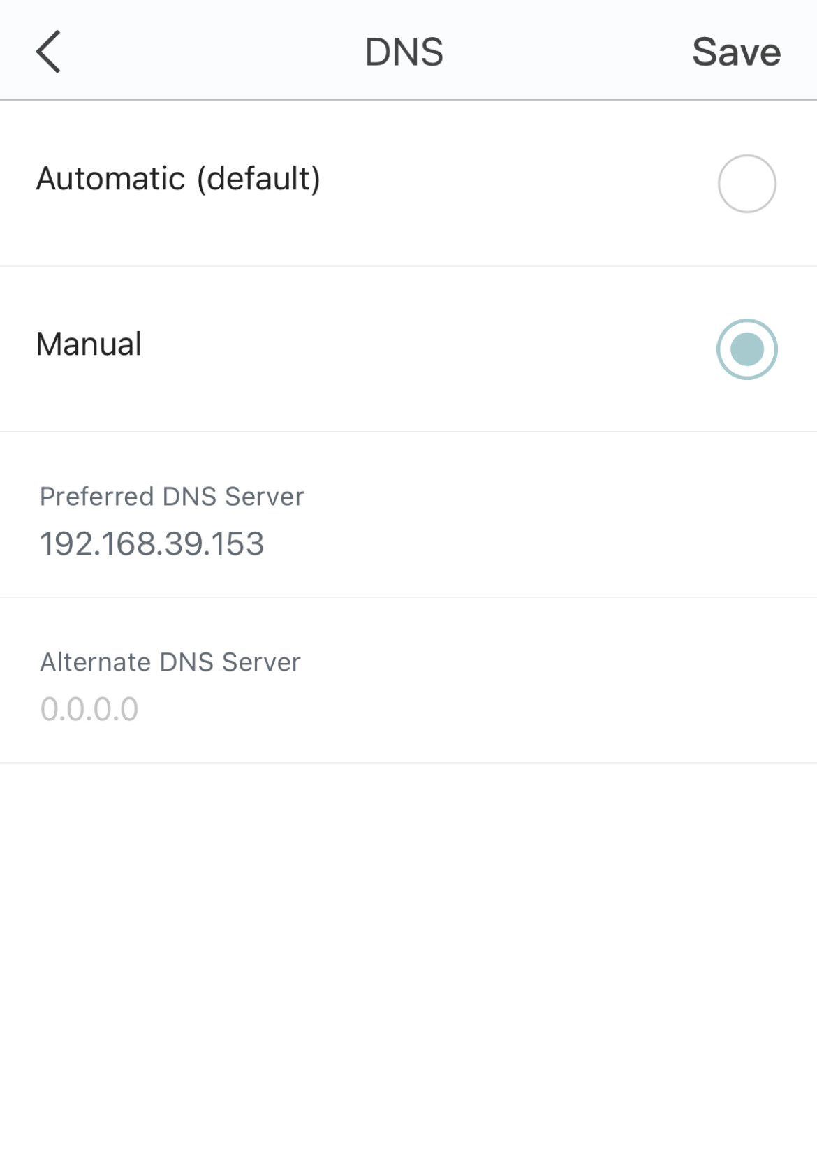

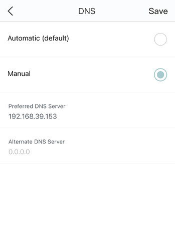

Is that it in the DNS section just below? What is in there?
This is the only setting where i can point the pihole’s dns, but as others have told me here my router does not respect this setting properly if not set manually on the device.
Would you suggest setting this setting to use a different dns and set piholes ip within the dhcp server setting maybe? I’ve done an attempt to set this already without changing the dns first, this like i mentioned earlier locked me out of the network, and i lost access to the admin panel to turn on pihole dhcp.
Yes that would be where you switch it to manual and put in the Pi-hole's address 192.168.39.153. The screenshot already shows this, so I assume that this was you already changing it before posting? Because further up your debug log showed that the router was giving out 193.168.39.1 (itself) as the DNS.

Couple of paragraphs from the user manual I found online, translated with Google Translate.
DHCP Server
Omni uses 192.168.39.xxx as the default IP range for distributing IP addresses etc. If you want to change to another IP address range, you can do this by pressing Manual. Then enter the desired IP address range and press Save.
DNS
Omni uses as standard DNS addresses it receives from the internet modem. If you wish to
use other DNS addresses, you can change this by pressing Manual, enter new DNS addresses and press Save.

I'm sorry. No the "Preferred DNS server" setting you see here with with Pihole's adress has been set for a long time.

I have been using the router's standard DHCP setting all this time. With this I'm trying to say I changed the DHCP server IP from 192.168.39.1 (standard) to 192.168.39.53 (manual), to try and tell it this will be the new DHCP server, while still having 192.168.39.53 set in the DNS section on the other setting, so i was wondering if that was a mistake or if that is the right way to try to do it somehow. But i see now with the manual you found (that did not come with my router but i wish it did) that this is for setting local dhcp range, but there is no information about an endpoint to that range, so i don't understand.
Can i, or how can i, use these available settings switch to using pihole as dhcp server in the web interface? Another question i have is, how can i be sure these repeating www.microsoft.com queries even stop if i do that?
Can i set one range in the router's DHCP settings, and another in pihole's to not conflict somehow maybe? again I don't know what end range the router is, i only know the starting range.

I assume that's a typo here, as further up it's 153 not 53. Double check your entries.
I don't know, this router interface seems to have limited configurability.
That's what I do, so I can switch from the Pi-hole's DHCP server to the router's DHCP during any downtime needed and be sure there will no lease conflicts, but it's important to note that you still need to have just one DHCP server running, so you're back to switching off the router DHCP. If that's not possible you'll have to experiment with how to make it hand out the Pi-hole as DNS, if that is possible. The screenshot you posted seemed to show it was, but then your experience and debug log says the router is handing out its own address as DNS.

The router's DNS setting configures its own upstream DNS only, not the one send to DHCP clients. And in DHCP settings, no DNS can be configured. And I also do not see an option to disable the router's DHCP server, so that Pi-hole's cannot be used either. I'd contract the router's support and ask about:
  • Whether/how it's possible to disable the router's DHCP server
  • Whether/how it's possible to customise the DNS server that is handed over to DHCP clients
  • Whether the router sends very frequent network requests to www.microsoft.com, if so for what purpose and whether/how it can be omitted
