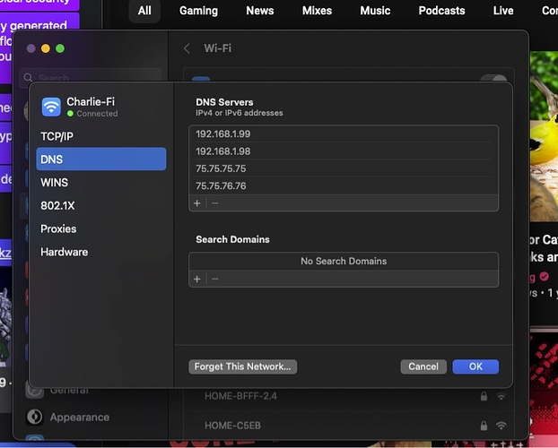

New issue is the router automatically assigns dns from the isp as dns entry 3 and 4 and there is no way to stop this

Please advise on solutions i have had issues using pihole’s dhcp server but that might be my only choice other than buying another router
Ive even added 75.75.75.75 and 75.75.75.76 to the firewall with no results

The solution to this was to buy a tp-link router, my archer cs4 is working with pi-hole flawlessly and isn't doing anything extra regaridng DNS
