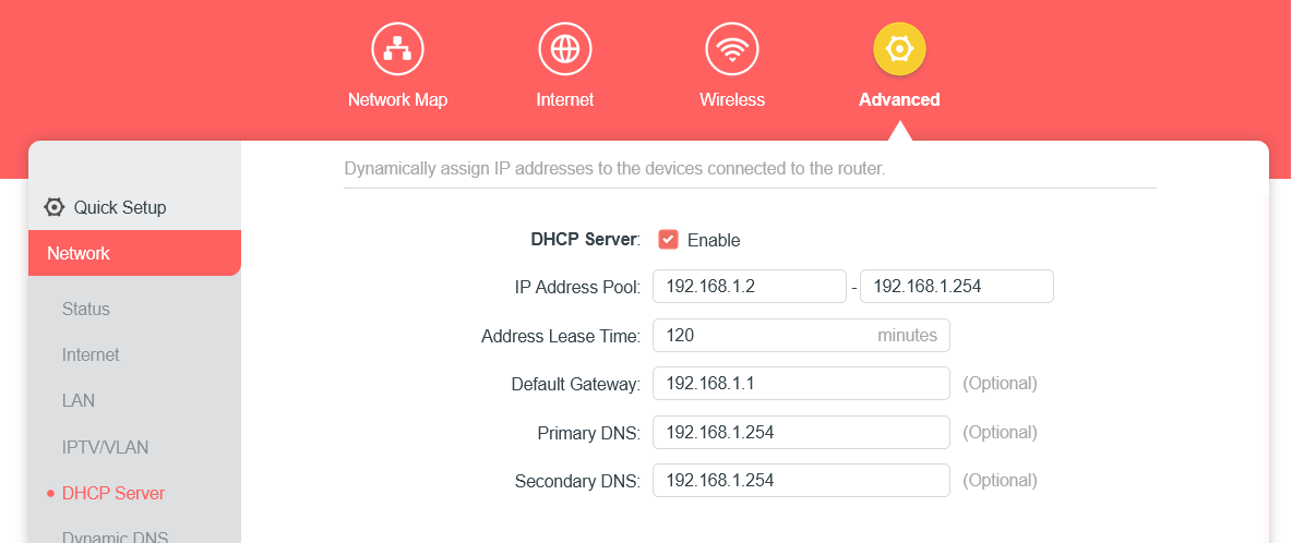

If your router is similar to this one, I think it would be better to use the router as DHCP server.
You should use the Advanced settings.
  • "Internet" page, use the default values set by the ISP, or use Dynamic.
  • "LAN" page, leave as it is (your router is using 192.168.1.1).
  • "DHCP" page, keep the DHCP on and use values like this :

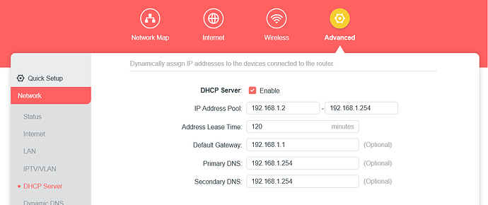

    Then set a reservation for Pi-hole like this (using the correct MAC address):
Note:
Your admin page may look different.

I do have a question about your choice of the IP pool. Is this random selected, or is there a logic behind the specific 1.2 - 1.254?
Can I change my Pi's IP to for example 192.168.1.55 If my router has 192.168.1.1?
When I type hostname -I it shows the IP set from my router, is this correct? And this IP I can change in nmtui to a static IP of for example 192.168.1.120?
You can use any range you want. It was an example.
Yes.
We usually recommend to reserve IP addresses from outside the pool range, but when I used the router simulator, apparently this router works differently and the reserved addresses must belong to the address pool, so any IP between start and end address will work.
If the router is the DHCP server, than this is correct.
You don't need to do that if you follow my recommendation to set a DHCP reservation for Pi-hole, on the router.
If you decide to set a static IP using nmtui, then you need to use an IP outside the DHCP range (to avoid conflicts) and you don't set a DHCP reservation on the router.
It is one or the other. Or a static IP set via nmtui, or a DHCP reservation. Also, the machine needs only one IP: or 192.168.1.55, or 192.168.1.120.
