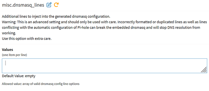

To apply them, you'd need to configure Pi-hole to not manage interface listening behaviour at all, by switching dns.listeningMode to NONE, under All settings Ā» DNS server .
You could then add your desired custom configuration to Pi-hole.
For just a few lines, you could use misc.dnsmasq_lines under All settings Ā» Miscellaneous.
If instead you want to manage your own custom dnsmasq file under /etc/dnsmasq.d/, you could alternatively enable misc.etc_dnsmasq_d.

Did you try to add something like except-interface=vlan to misc.dnsmasq_lines?

I’ve created a file named 10-listen.confin /etc/dnsmasq.d/ with the two lines below:
listen-address=<IPv6 global listen address>,<IPv6 ULA listen address>,<IPv4 legacy listen address>
bind-interfaces
And it works like a charm.
Thank you
Dont need to.

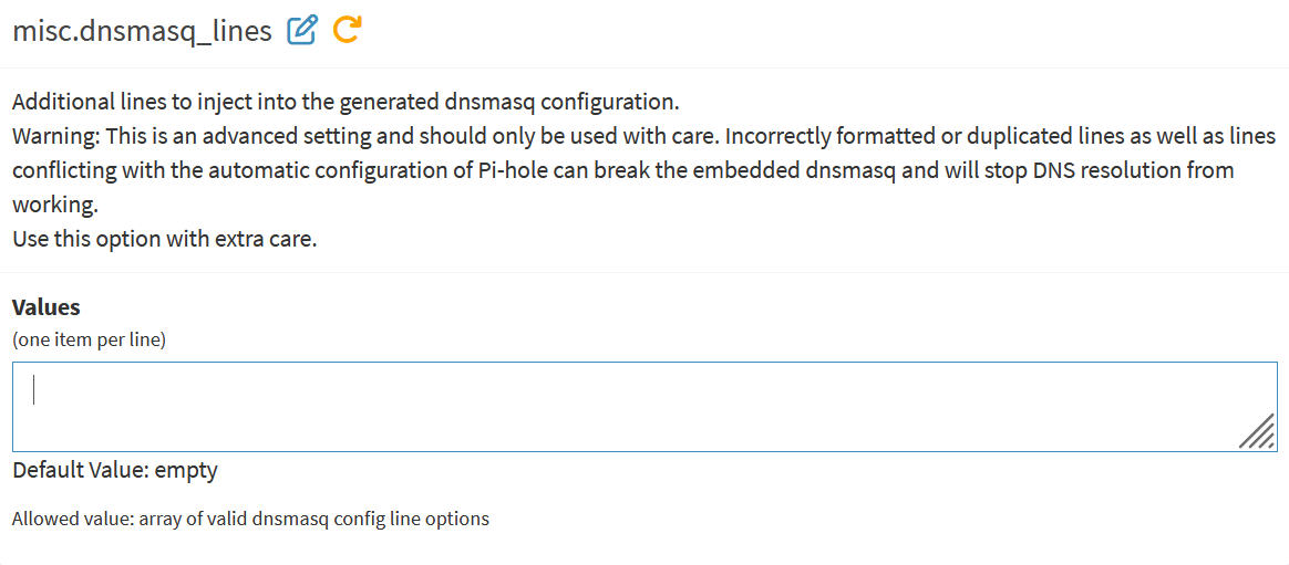

Can drop those two directives directly into webGUI below:
Or via shell:
sudo pihole-FTL --config misc.dnsmasq_lines '["listen-address=<IP_ADDRESSES>","bind-interfaces"]'
