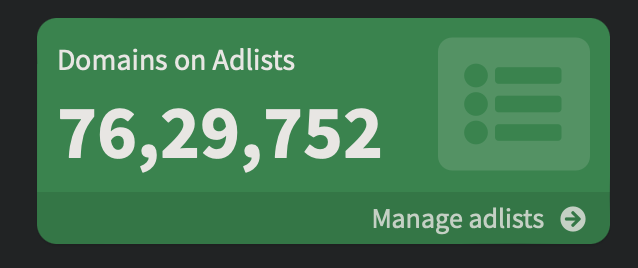

Plenty gets through.
That chart isn't very informational, as it doesn't have any details on domains (e.g. could be always the same domain).
Also, we don't know what's on your list of allowed domains (I recall you mentioning having to whitelist a lot of domains from another post).

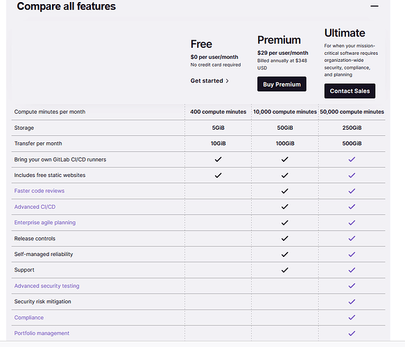

Gitlab has a free tier 5GB
that's total. not per file
Totally missed that, what is the "per file limit" ?
