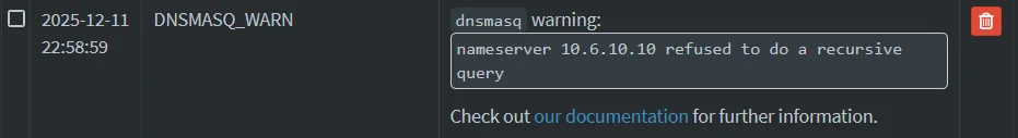

I have a warning that has started appearing in the diagnosis tab:

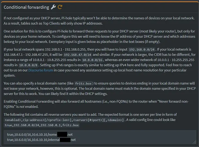

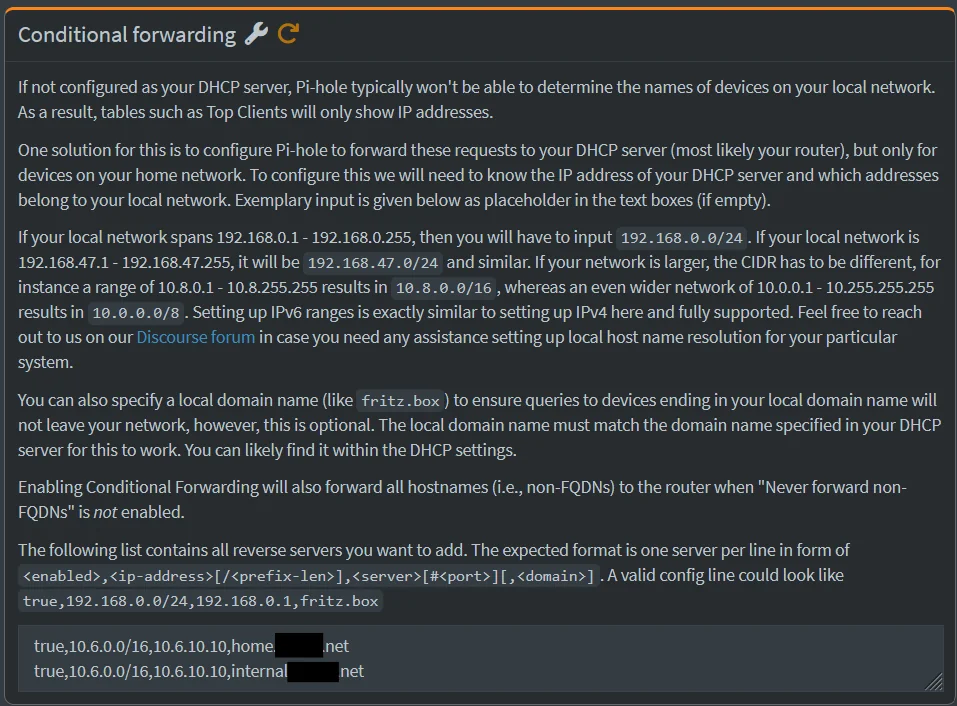

Where 10.6.10.10 is a local Samba AD DC running a DNS server that manages DNS for all my local services. It is configured for conditional forwarding, acting as the upstream server for my local subnet (10.6.0.0/16) and my local domain (*.home.mydomain.net, *.internal.mydomain.net):

2025-12-11 23:00:00.169 AEDT [5383M] WARNING: dnsmasq: nameserver 10.6.10.10 refused to do a recursive query
2025-12-11 23:00:03.833 AEDT [5383M] WARNING: dnsmasq: nameserver 10.6.10.10 refused to do a recursive query
2025-12-11 23:00:04.835 AEDT [5383M] ERROR: add_message(type=5, message=nameserver 10.6.10.10 refused to do a recursive query) - SQL error step DELETE: database is locked
2025-12-11 23:00:04.836 AEDT [5383M] WARNING: dnsmasq: nameserver 10.6.10.10 refused to do a recursive query
2025-12-11 23:00:05.837 AEDT [5383M] ERROR: add_message(type=5, message=nameserver 10.6.10.10 refused to do a recursive query) - SQL error step DELETE: database is locked
I don't want my local DNS to be a recursive resolver, I don't want any queries to it forwarded upstream... I have no idea why this only started happening recently. Does anyone know why and how to make Pihole not expect it to be an upstream resolver, as it seems to be the cause of the intermittent issues with DNS I am seeing.

The only queries being sent by Pi-hole to this server are the ones for the domains you have specifically added in your configuration above.
The configuration screenshot above makes perfect sense for what you are trying to achieve. Pi-hole would be sending only local network queries to Samba, and it would be sending them with the recursive bit set.
