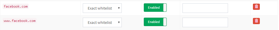

zusätzlich zu facebook.com muss static.xx.fbcdn.net (CNAME Block) auf die Whitelist.

Whitelist www.facebook.com and remove the whitelist entry for static.xx.fbcdn.net

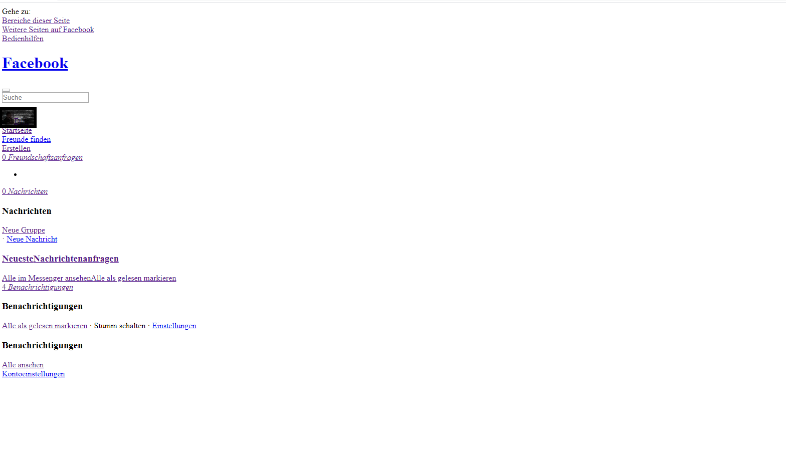

If i only Whitelist
facebook looks like this

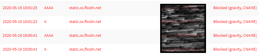

and i have this entry´s in the Query Log
I have to whitelist static.xx.fbcdn.net that facebook will shown correctly
