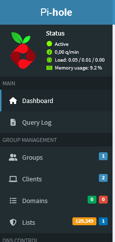

If I'm posting in the incorrect place my apologies. I'm very new at this so I'm not so sure if I configured pi-hole correctly or not. There is just much info out there regarding pi-hole itself and using your router for configuration. I may have made some incorrect information changes to get the best blocking possible on my streaming desktop devices while using pi-hole. I was trying to tie in the pi-hole with my ASUS Mesh router DNS if that's possible to protect all devices. But I get a lot of conflicting information for example in many ways either use your router or pi-hole DNS. I run DEBUG so it may explain something I don't understand it. I want to confirm that I have pi-hole configured just perfectly so I don't experience any bad behavior with tracking or advertisements.
Not so sure if it is even blocking advertisements or trackers at all it shows only One Queries blocked.

You have no adlists.
(you added the adlist in the wrong place)

You created a Group called https://v.firebog.net/hosts/AdguardDNS.txt. This won't block anything.
  • Delete this group in Groups page;
  • Go to Lists page and add your list (https://v.firebog.net/hosts/AdguardDNS.txt). Make sure it is assigned to the Default group;
  • Go to Tools > Update gravity and click on the big button to update it.

Okay, I followed through with update gravity. I believe all this started when I was reading different topics from the net on how to configure pi-hole with router. When I first installed this and run it seem to work just fine and blocking until i messed with the configuration. I guest I should of left it alone. I just want the best blocking possible that I can get. Regarding Adguard list, At the beginning of this thread I believe that I was told I have no lists at all in the section so I was instructed to add this list as instructed by last communication. At first, it was in the wrong place. So I'm not so sure what other lists to add?
