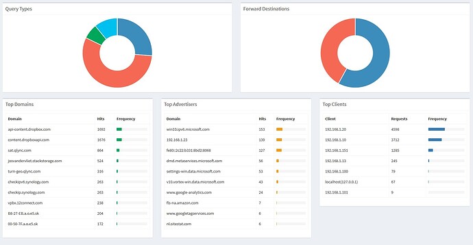

My raspberry is the top advertiser according to the pi-hole admin console. It puzzels me because on my rasperry I'm only running pi-hole and boinc so there's not much action over there I think.
Is this normal behavior or, when not, do you have any idea what might cause this? It might be that I don't understand the principle that good.

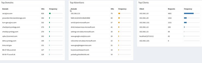

I've added a screenshot of the admin console so you can see all the info.
192.168.1.23 is the Raspberry and today (so far) it's on numer two of the Top Advertisers list.

What I find strange about this is that it's showing as the IP... which.. it shouldn't be.
