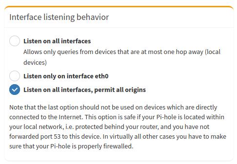

Which listening mode did you chose on the web interface?
Try the most generic and and check if the error persists:
It was set to Listen on all interfaces. I have changed it to Listen on all interfaces, permit all origins and that solves the problem I was having (it does not require any delay). The pihole-FTL.conf file looks identical to the "without delay" log I posted before.
Any ideas why this option fixes it?
These descriptions are a bit superficial. Going into all the gory details on the frontend would surely explode it and would also make it a lot less user-friendly. Internally, the difference is that before your Pi-hole was binding to all interfaces and
Accept DNS queries only from hosts whose address is on a local subnet, ie a subnet for which an interface exists on the server.
(quoting the dnsmasq man page)
With the new setting, this is slightly changed by not enforcing the locality of the queries and, hence, be more generic.
Do you see the listening on ... messages now?
