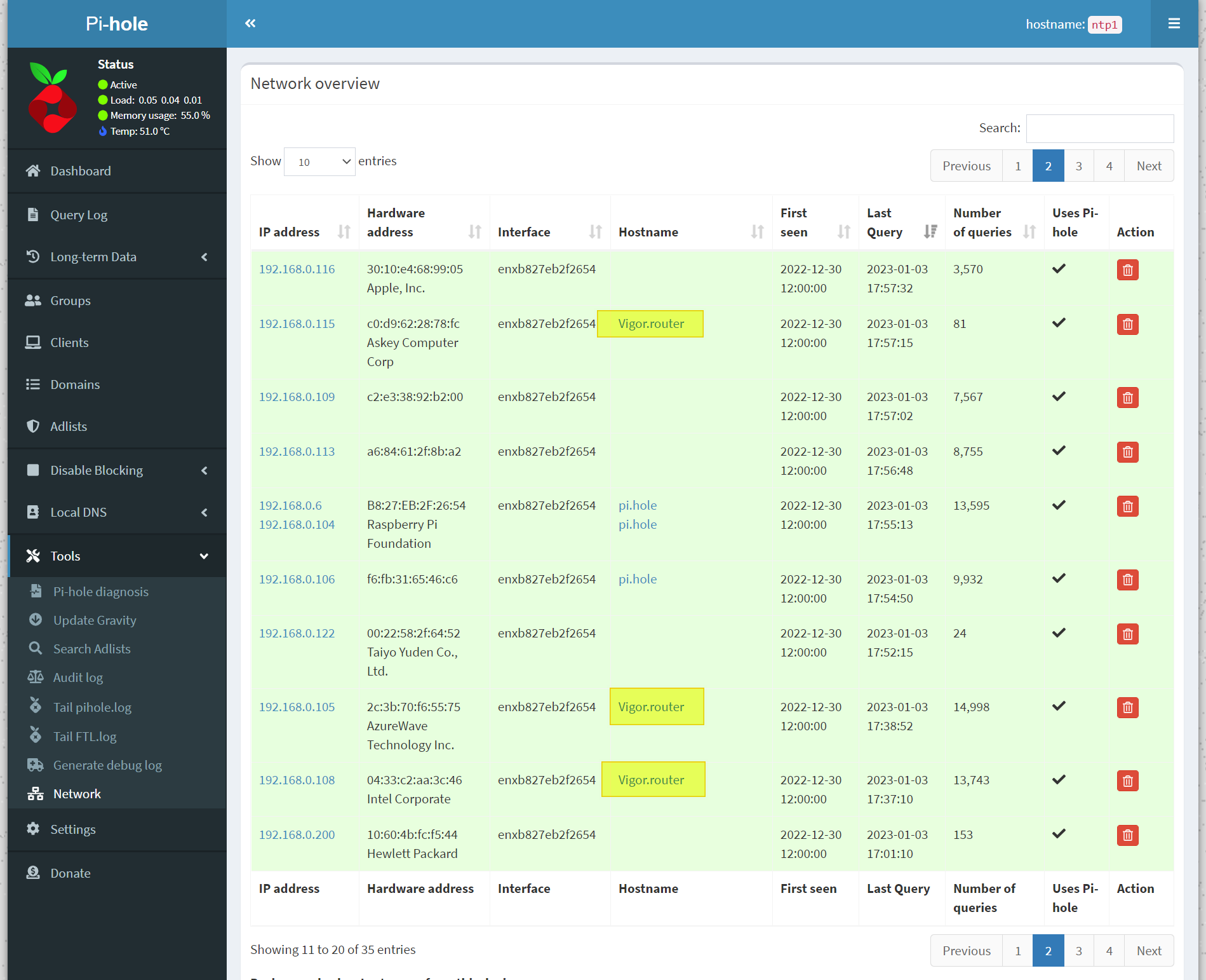

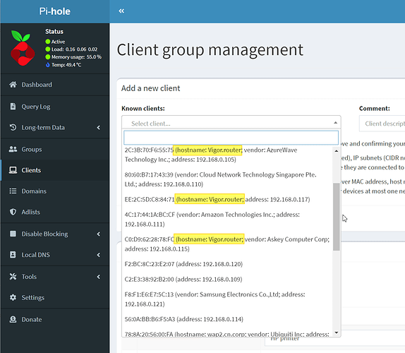

The problem is that "Vigor.router" is still floating around in my system - if I go to the "known clients" drop down under "client group management" it's appearing multiple times in the list against other clients and also in the query log.
I had a look in the FTL database and cleared out both network and networks_addresses but it just keeps coming back. Then I found another table which seems to store the client names and IPs where I can see "Vigor.router" appearing multiple times:

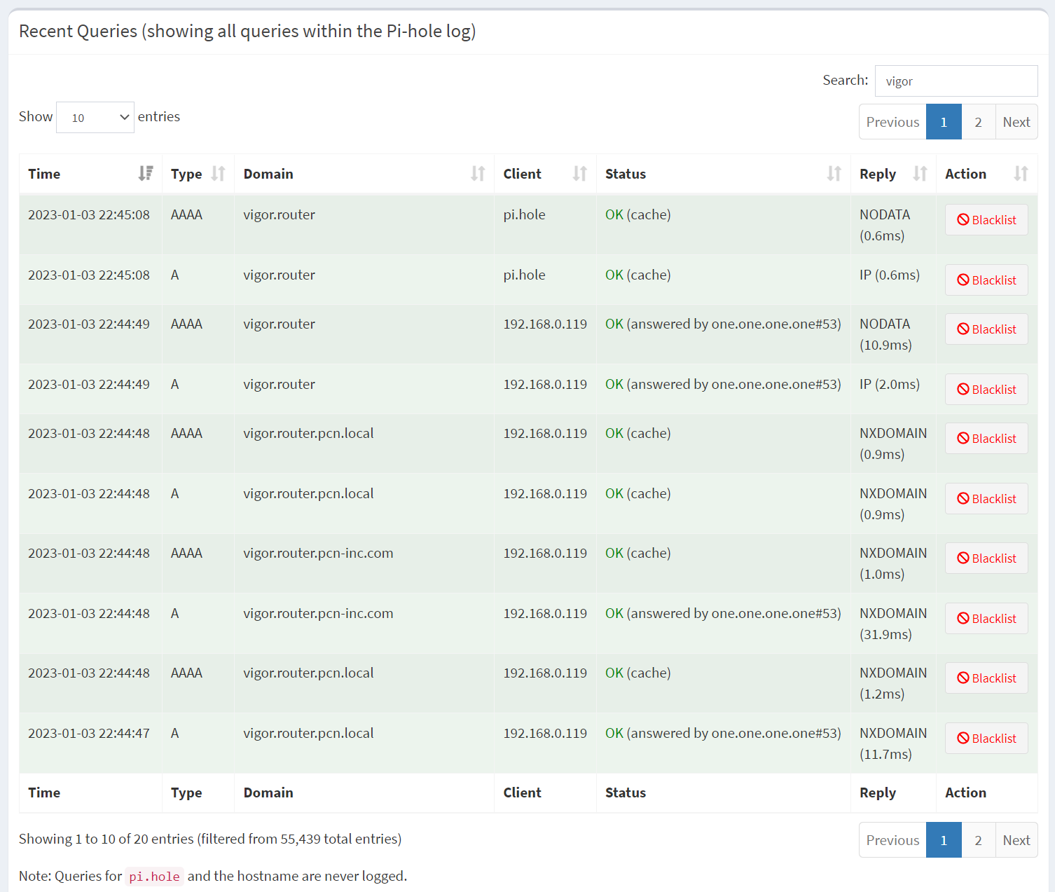

pihole.log shows this:
Jan  3 11:52:14 dnsmasq[1017]: query[A] vigor.router from 192.168.0.119
Jan  3 11:52:14 dnsmasq[1017]: forwarded vigor.router to 1.1.1.1
Jan  3 11:52:14 dnsmasq[1017]: reply vigor.router is 192.168.0.1
Jan  3 11:52:14 dnsmasq[1017]: query[AAAA] vigor.router from 192.168.0.119
Jan  3 11:52:14 dnsmasq[1017]: cached vigor.router is NODATA-IPv6

It looks like my Draytek Vigor router is doing DNS interception - I need to do some googling on that, maybe it's part of the parental control features but I've got all that turned off. There might be another setting somewhere I need to tweak.

Unfortunately I had the Pi-hole set to use the vigor IP as it's DNS resolver so now that name seems to have found it's way into the client table and different clients are being identified with that name.
Let me see if I can upload a screenshot...
So now that the Pi-hole is not using the vigor anymore for it's DNS resolver what I'd like to do is remove these entries from the FTL DB.
If I remember correctly, I've resolved similar issues with odd or incorrect system names by creating a "fake" DNS entry in Pihole for a device, then deleting it.
Local DNS
DNS Records
Enter a fake domain name entry pointing to the IP address you're having a problem with
Delete the entry
Holy crap that worked! As well as setting the dummy DNS name I also had to delete the clients from the "network" page, but when they were rediscovered they came back without the host name. Brilliant, thanks!
