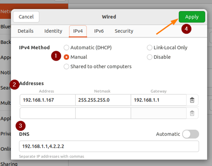

If you run a desktop environment, you most likely can set a static IP via one of the desktop applets/settings.
No need to dig into the shell.
Quick duckduckgo,
scroll down to "Setup Static IP address via GUI (Desktop Environment)":
Once set, below one should say ipv4.method=manual for your active network profile:
nmcli -t -f name con show --active | xargs -d '\n' -n 1 nmcli -p -f ipv4.method,ipv4.addresses,ipv4.gateway,ipv4.dns,ipv4.dns-search con show

Finally I had a time to have a look at it.
Before I am gonna disable the DHC on the modem - are these the correct settings?(I could not disable the DNS toggle, even though I was able to write inside that field - not sure if I need it at all, since pihole should be taking care of that)
I just want to be sure, as to avoid the factory resetting the modem, like last time.
Okay, so I bit the bullet and tried it anyway - it does work!
So I needed to:
1.) setup the DHCP server on Pihole,
2.) set the static IP address on the Raspberry Pi itself (as your link describes it):
3.) and then disable the DHCP on the Modem itself
4.) Do the ipconfig/Release / renew and restart the PC - works like a charm!
