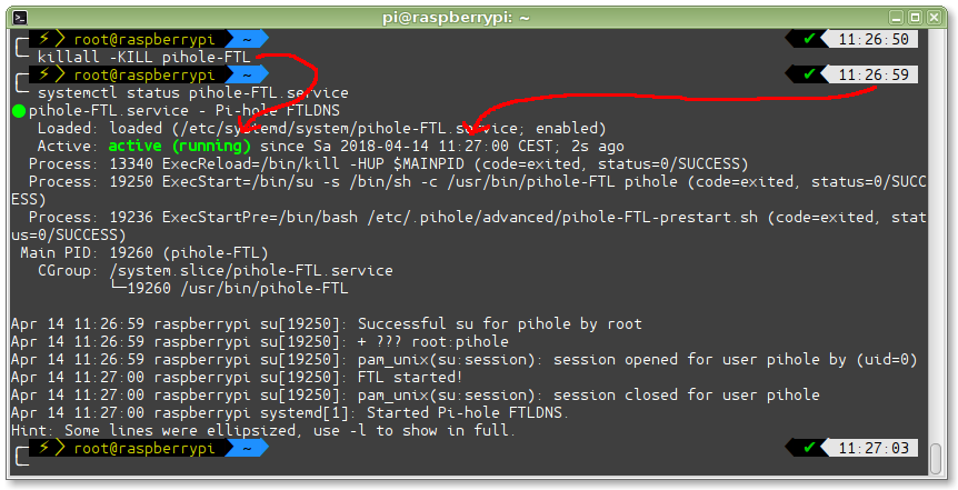

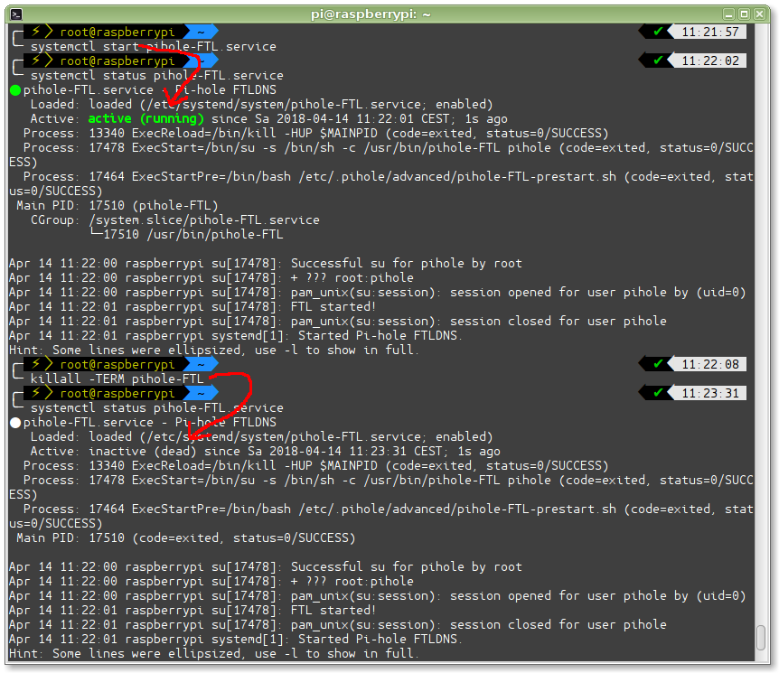

**What does this PR aim to accomplish?:**
Replace the ancient `init.d` script for starting and controlling the `pihole-FTL` process by a modern `systemd` unit. This should resolve some problems as discussed [here](https://discourse.pi-hole.net/t/service-pihole-ftl-active-exited/8335) or [here](https://discourse.pi-hole.net/t/pihole-ftl-is-working-but-webmin-says-the-service-is-not-running/8368).
This now also makes the `status` command behave correctly, as `systemd` can use the PID file of FTL to find out if it is actually running or not:
Also, since *FTL*DNS is a very important part of your system, the unit ensures that it will be automatically restarted whenever something unexpected happens. As an example, I sent `SIGKILL` to FTL and as you can see, `systemd` took care about immediately restarting the service:
Note that we do not restart `pihole-FTL` automatically after having received `SIGTERM` as this is the correct way of terminating the resolver (e.g. through `service pihole-FTL stop`).

I wrote a systemd unit for `pihole-FTL` and modified the installer to replace the old init.d script.
