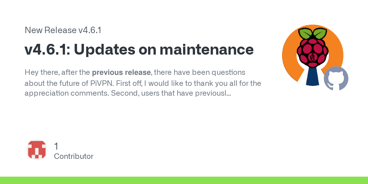

PiVPN's github, it's far from EOL - infact just today there was an update to allow it to install with pihole v6 (i raised a ticket on their github and 48 hours later it was updated and fixed)

Hmm...
It looks like the developer changed his mind partially :
"Low Effort Maintenance Mode" it is then :slight_smile:
