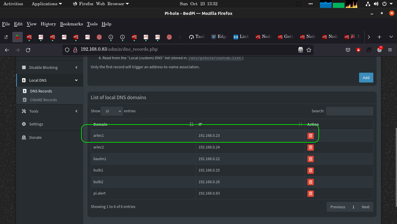

The issue I am facing:
In the Local DNS/DNS records part I can enter/create entries so rather than typing the IP, I can enter a name.
Or: that is the idea.
It isn't working.
See screen shot:
arlec1 for instance.
This machine is set up as the DNS for my network and I am seeing weird things happening on the DNS side of things.
For the sake of keeping things as simple as possible: ALL is done on that machine.
So, I say: ping arlec1 and it just doesn't like me.

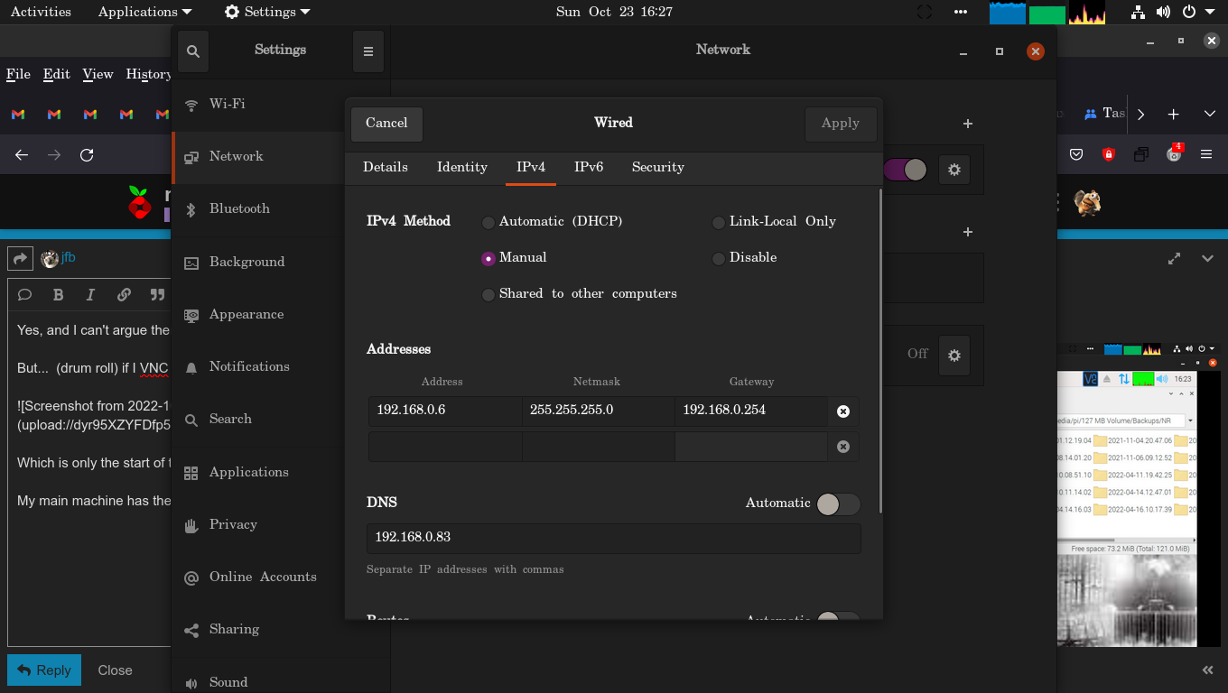

To digress for a moment to a Ubuntu machine I see this:
resolvectl status
Global
Protocols: -LLMNR -mDNS -DNSOverTLS DNSSEC=no/unsupported
resolv.conf mode: stub
Link 2 (eno1)
Current Scopes: DNS
Protocols: +DefaultRoute +LLMNR -mDNS -DNSOverTLS DNSSEC=no/unsupported
Current DNS Server: 192.168.0.83
DNS Servers: 192.168.0.83
Note the -mDNS
Does that mean this machine is NOT seeing a mDNS server broadcasting on this network?

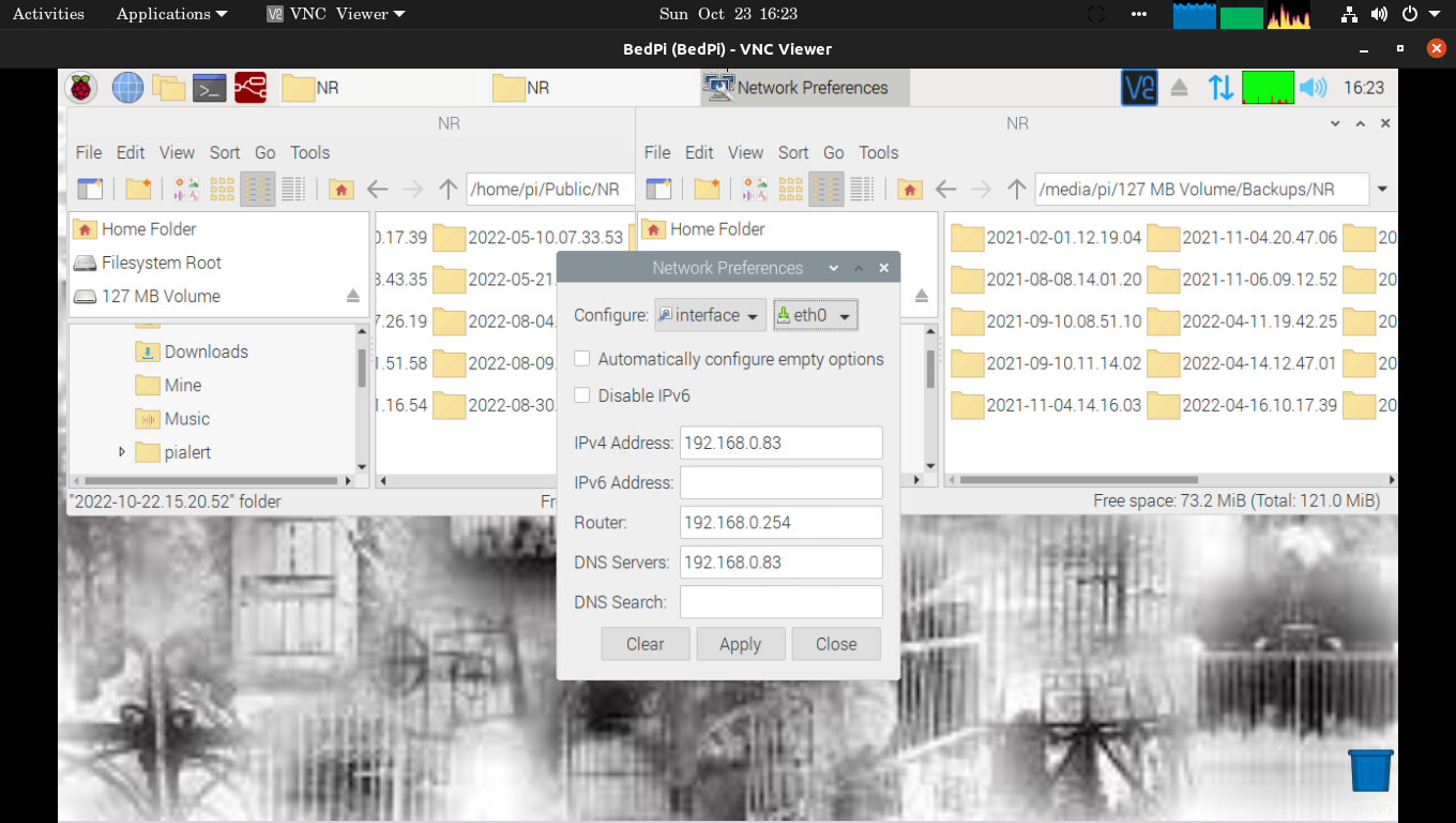

After searching I hope I have all the right things set.
avahi-daemon is/was restarted after the edit.

Details about my system:
RasPi 2B Buster running PiHole.
PiHole 5.13
FTL 5.18.2
GUI 5.16
I am not sure I have CHANGED anything.
I am just not understanding why mDNS isn't working.
