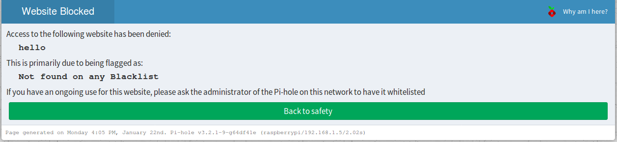

I generate the blocklist from the "query[A] mail.yahoo.com from 192.168.1.10" with my log extractor program in QB64 at https://smokingwheels.github.io/qb64/piholelogext.bas and look for invalid things. There more evident when I run a YaCy search engine.
An Idea? I could feed my Pihole with invalid things and see what happens if it affects performance.
Example:
nslookup hello' 'f.com 192.168.1.5 (Forum leaves out spaces. 5 in total).
Result:
hello\032\032\032\032\032f.com
Ask Browser to contact and result.
I welcome any comments.

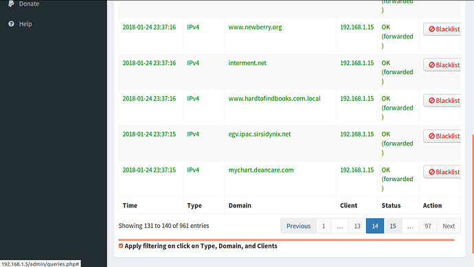

@DL6ER I have a small collection at https://smokingwheels.github.io/Pi-hole/fromlog
0.0.0.0 chandelur3.tumblr.com.local
0.0.0.0 (space)chanelbags.cheapchanelbags13.us#azqvq
0.0.0.0 (space)chanelbags.topchaneloutletbags.us#xffpc
0.0.0.0 chanell.yandere.local
With normal internet use these are not found.
Those aren't valid domain names. You can't have spaces in a domain name and the octothorpe is an artifact from improper list parsing.

Is this your pre-filtered config file or your post-filtered? That list is mostly invalid domain names. You can include them in the dnsmasq configuration, but you're just wasting space as no client will ever query the Pi-hole for them.
Post-filtered list to load onto my Pihole.
It only happens when I run a yacy search engine like now. Maybe I should file a bug report on yacy?
