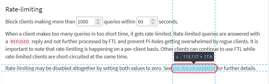

I will enable the rate limiting feature in pi-hole and see what happens next.
It looks like the only way to turn Rate-limiting on and off is in the config file?
Is there any option within the web console to do this?
Settings > DNS tab
Rate-limiting may be disabled altogether by setting RATE_LIMIT=0/0 (this results in the same behavior as before FTL v5.7).
