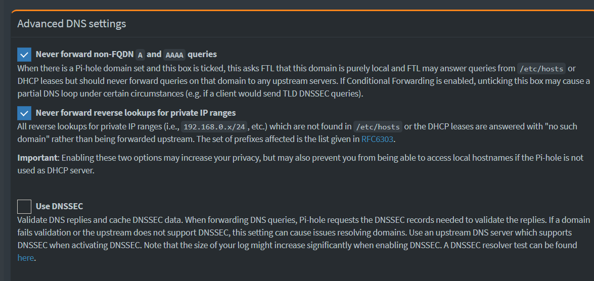

Hi Hakke, thanks a lot for taking the time to reply.
I've double checked in case I've forgotten and Conditional forwarding is not enabled on my pi-hole. Below a couple screens with DNS config.

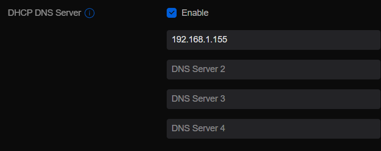

Additionally, DHCP server is not enabled for my Pi-Hole, but I do have it configured as primary DNS within my network's router:
