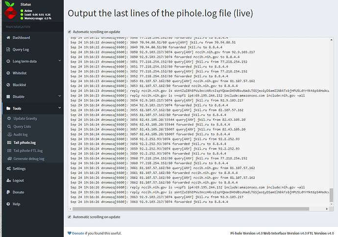

Hello guys,
I use pihole since some time and it is amazing.

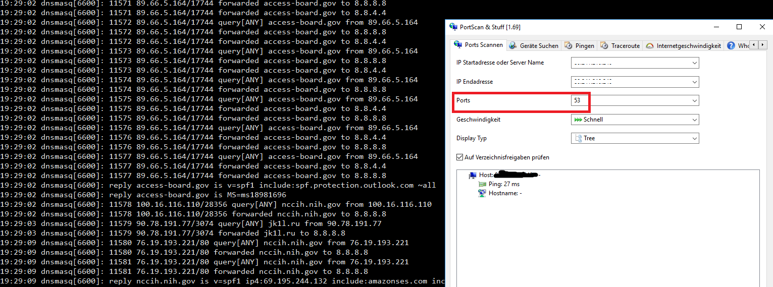

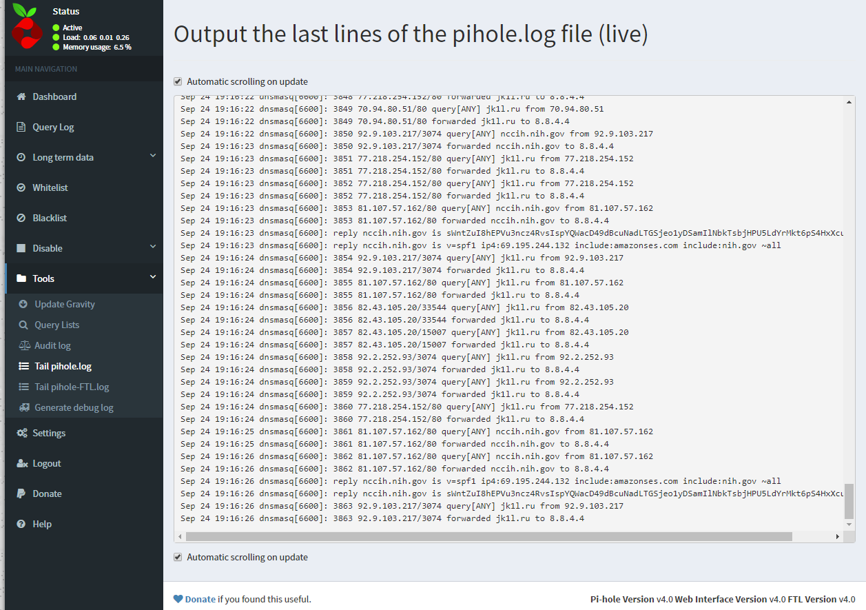

But yesterday I checkt after some time the pihole live tail again via SSH "pihole -t" and found a lot of strange requests, looks like a botnet attack (jk1l.ru).
In the normal query log and clients log (beside the scanning servers with 1 request) everything looks normal.
Than I checked my VPS via "tcptrack -i eth0" and on the server are only a few IPs connected.
I don´t know how I can block this many requests. Tried some things via "iptables" and connected my VPS provider but they can´t see no DDOS attack.
It would be great if you have some idea to help me.
Thanks guys

It would be best if you close port 53 from being exposed to the web ...
Looks like indeed someone is using your DNS server (Pi-hole in this case) for all those requests.

But I tried to close the port via iptables, command: "-A INPUT -p tcp -m tcp -m multiport -j DROP ! --dports 10000,80,8080,3000,22"

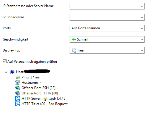

Via SSH I can see that I still have requests. The port scanner told me that port 53 is closed.

You are receiving DNS requests from (what seems like) random IPs
ip: "70.94.80.51"
hostname: "cpe-70-94-80-51.kc.res.rr.com"
city: "Grandview"
region: "Missouri"
country: "US"
loc: "38.8858,-94.5330"
postal: "64030"
name: "Time Warner Cable Internet LLC"
domain: "twcable.com"
route: "70.94.0.0/17"
type: "isp"
ip: "77.218.254.152"
hostname: "m77-218-254-152.cust.tele2.se"
city: "Stockholm"
region: "Stockholm"
country: "SE"
loc: "59.3333,18.0500"
postal: "173 11"
asn: Object
asn: "AS1257"
domain: "tele2.com"
route: "77.216.0.0/14"
If these are NOT your friends (and I doubt that both or all of them are querying for that domain), your iptables rule does not work.

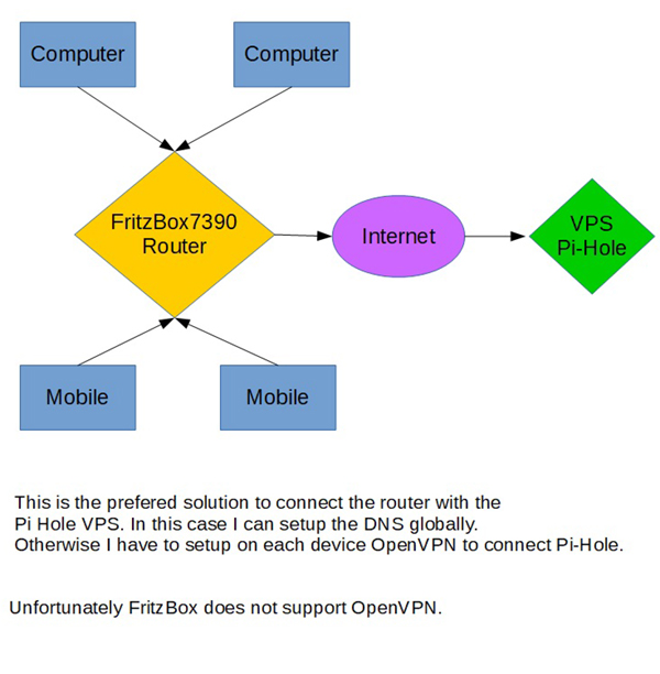

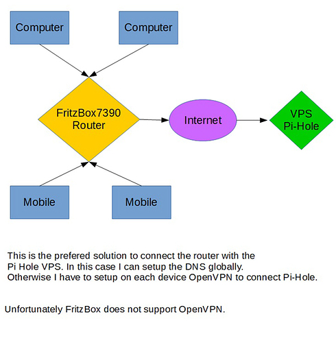

Hi jfb,
Yes exactly, I have the Pi-Hole installed on a VPS Debian 9 server.
My friends use it like me its set up globally in our router (fritzbox) to filter everything in the network (like mobile phones).
We don´t use a VPN for this, this could help because its a static IP but needs a VPN account for each home.
I also thought on a Geoip filter in iptables...
Thanks

Hi guys,
As far as I know it is only possible to setup in my router "FritzBox 7390" a VPN sever.
This means I can connect with my phone to my home router but nothing else like a Tomato router and OpenVPN.
So if i setup a VPN as a DNS shield I can not connect with my Fritbox to the VPS by default, just only with the devices directly (setup every device).
Maybe the best thing is to buy a Raspberry Pi and have it behind my router only?
Thanks for your quick help - amazing

Hi Ramset,
Thanks for your quick feedback.
I don´t know if I have understood it right.
This is my current setup:
I want to install on each device OpenVPN.
So I tried to allow only my city/country IP range for the whole VPS.
This will minimize the attack risk from somewhere else and is maybe a good compromise between VPN...
Iptable rules (example):
Before the block rules, I added my VPN provider (Iptables Accept) with a static IP address in case I can not connect again (backdoor).

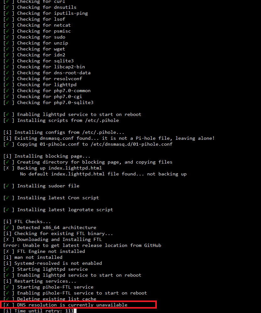

I tried via pihole -r to repair my installation.
and got with the city rule above the message
DNS resolution is currently not available.

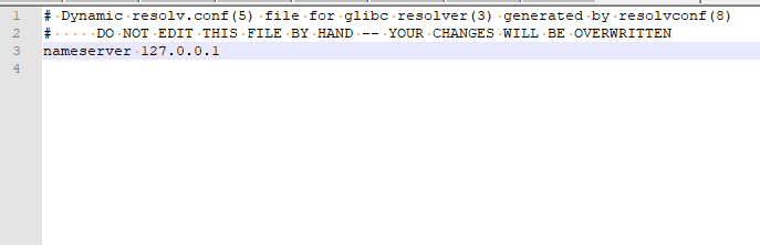

My Debian 9 VPS generate to following file in /etc/resolv.conf
Maybe this will help a lot to figure out whats going on.
Cheers and thanks
