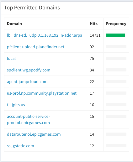

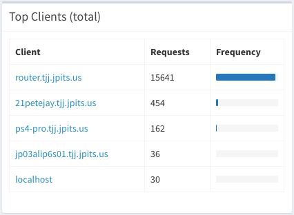

Many requests to "lb._dns-sd._udp.0.1.168.192.in-addr.arpa"
I should not be seeing requests to lb._dns-sd._udp.0.1.168.192.in-addr.arpa
I'm seeing lots of requests to lb._dns-sd._udp.0.1.168.192.in-addr.arpa

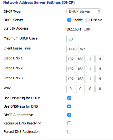

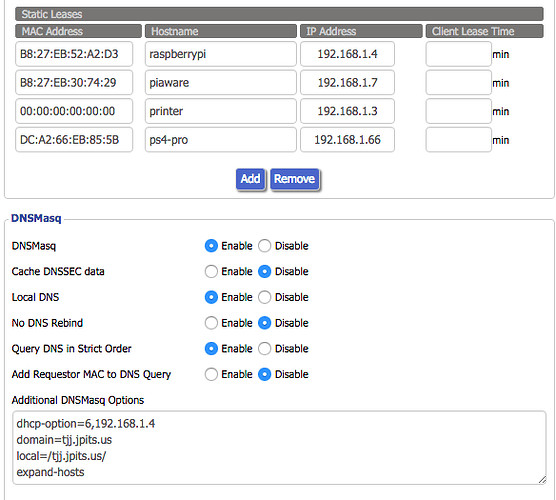

This is running on a DD-WRT Router. My setup is as follows:

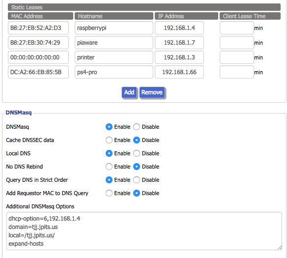

I have DHCP Option 6 set so that I can see which clients are querying what...

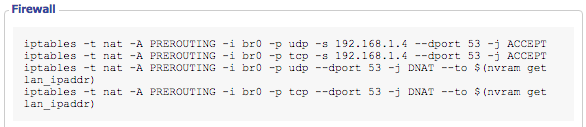

I'm pretty sure this has to do with my iptables forced dns redirection. As you can probably see:
Router IP: 192.168.1.1
Subnet: 255.255.255.0
Pi-hole IP: 192.168.1.4
Other Networks
192.168.10.0/24 (No Pi-hole as DNS)
What can I do in the GUI or iptables to stop these requests? I assume they should be going to the router, not from the router to Pi-hole.
Any Help Would be Appreciated!

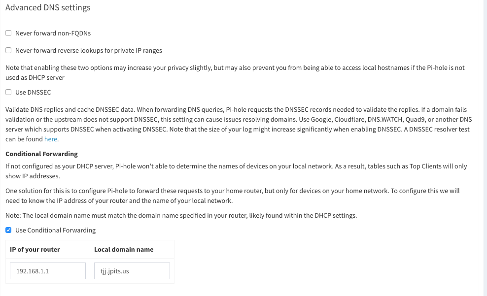

If you have conditional forwarding enabled in Pi-Hole, then de-select this option and see if that reduces the frequency of requests.
The requests are for DNS Discovery Service, commonly associated with the Bonjour network protocol.

I would assume, but why is it flooding Pi-hole?
It's flooding Pi-Hole because you likely have a loop between Pi-Hole and your router. This is commonly caused by having conditional forwarding enabled.

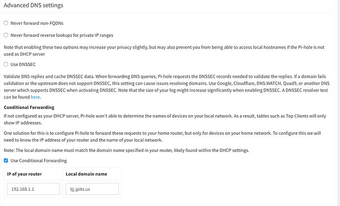

Do you have conditional forwarding enabled?

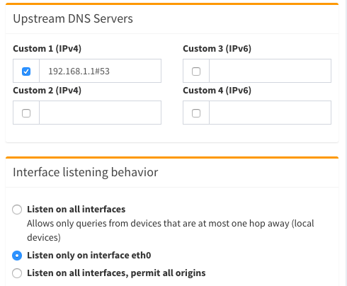

Not anymore. I disabled it and reanabled it, flushed the logs and not seeing it again...
First, I specified my Upstream servers in the router, kept the IPTables rules and then I did this:
No more requests!
I am happy now :wink:
