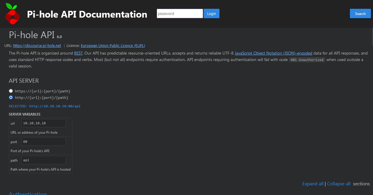

You can use the API documentation already installed with your Pi-hole: http://10.10.10.10/api/docs
In the API SERVER section: select http or https and use your IP as URL.
Also, remember to login (top bar) using your Pi-hole password.

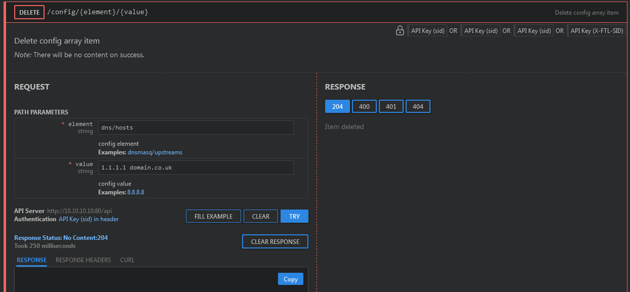

Then you can scroll down to DELETE /config/{element}/{value}, fill the parameters with dns/hosts and 1.1.1.1 domain.co.uk and click on TRY button.
You can select the "CURL" tab to check the command:
curl -X DELETE "http://10.10.10.10:80/api/config/dns%2Fhosts/1.1.1.1%20domain.co.uk" \
 -H 'accept: application/json'\
 -H 'sid: ksdEOTAqoWLlTg3Rxd57Xw='
useful to know, i didn't know that existed. thanks!
I still get a Response Status: Not Found:404 doing this - does it work for you?

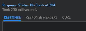

Yes, it does.
As you can see on the image, I received 204 status code, which means the item was removed and there is nothing to be returned:

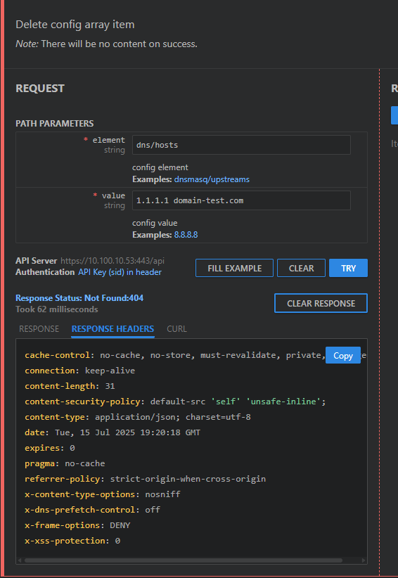

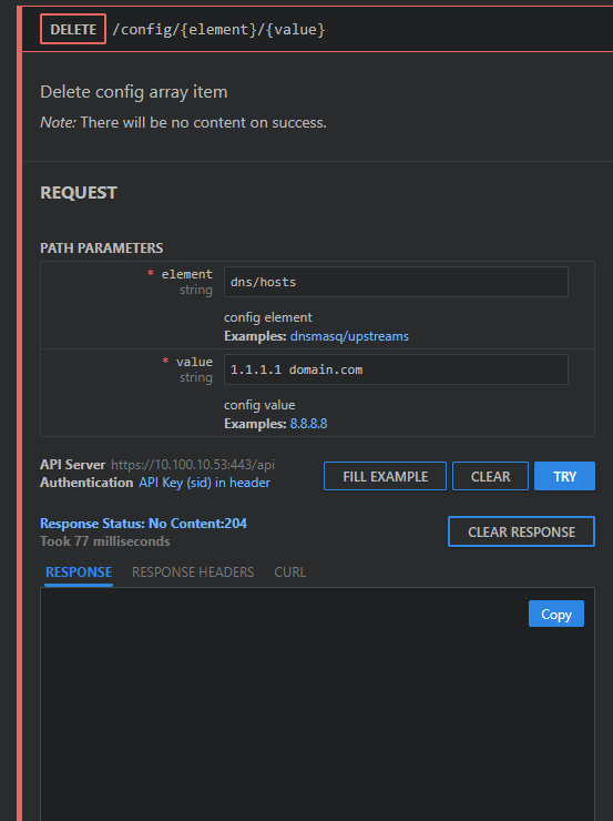

I may have found a small bug - the real domain I am using / testing with has a dash in it.
domain.com works fine
where as a URL with a - (dash) in it fails
domain-test.com

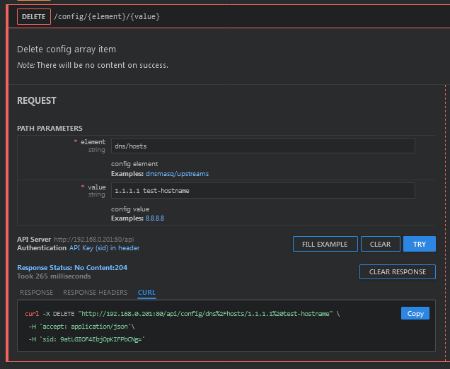

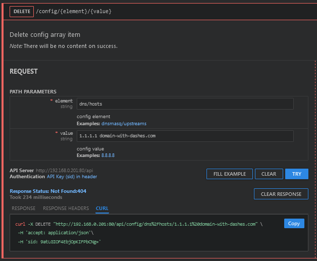

I only get 404 if I try to delete a non-existent host. In this case, 404 (not found) is the expected response.
I just tested creating 2 hosts containing dashes and then delete them using the /api/docs interface and everything worked:
very strange. I can recreate the issue consistently.
I am on version
Core v6.1.4
FTL v6.2.3
Web interface v6.2.1
okay i believe i have got to the bottom of this, when duplicating entries via the web GUI, if not careful a extra space char gets added to the domain name. This isnt then visible again via the GUI, but will mean the entry you try to delete via the API does not exist.
