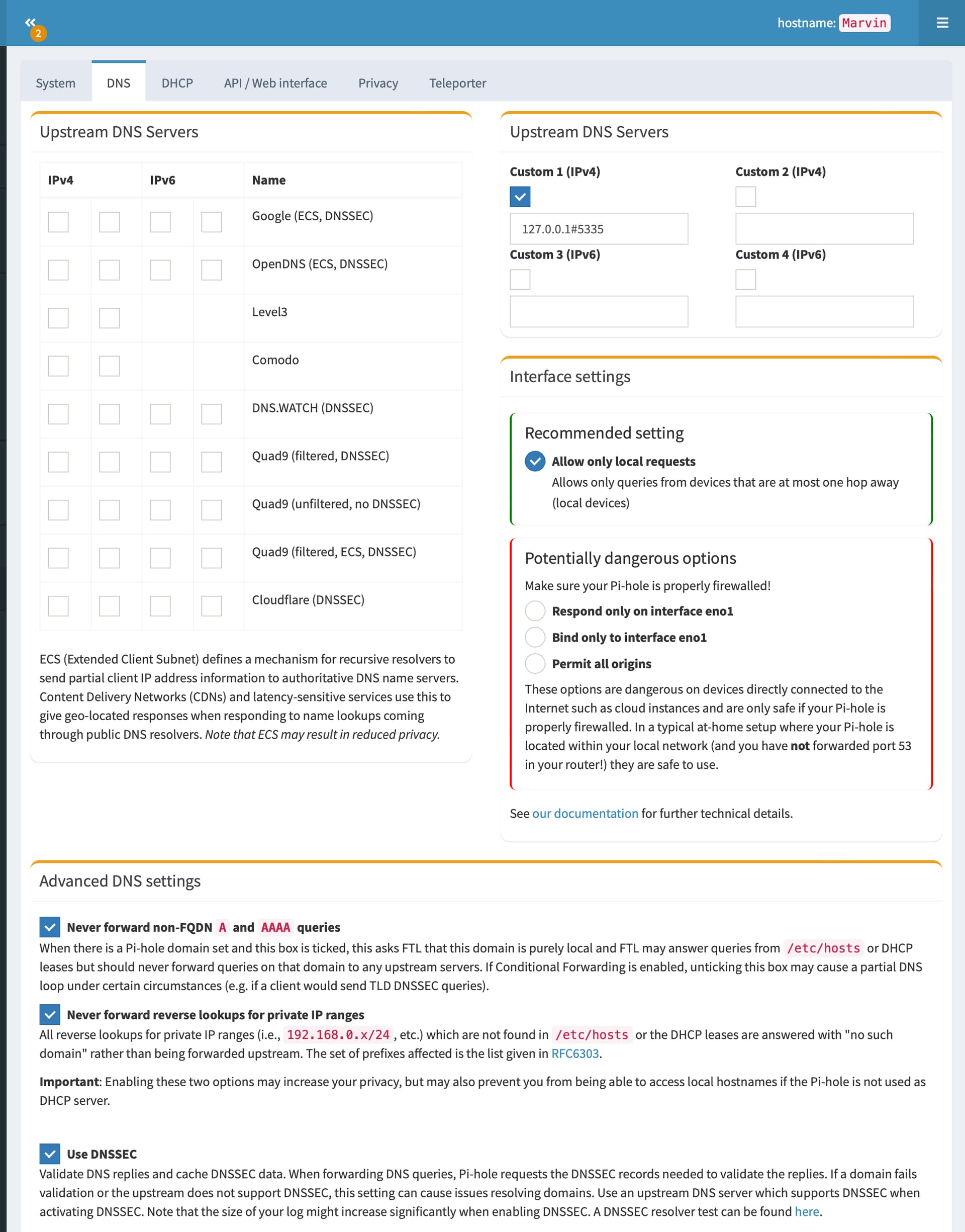

PiHole is configured to use Unbound as per this page: unbound - Pi-hole documentation

That is true, but unrelated to this problem. Unbound doesn't use any assignments from a DHCP server - it goes to the authoritative nameservers when you have it configured as a recursive resolver.

My understanding is that this would be used for clients on the network that were not pointed at PiHole on .10 Those pointed to .10 would "bypass" the settings for other clients and via direct lookup using Unbound.
