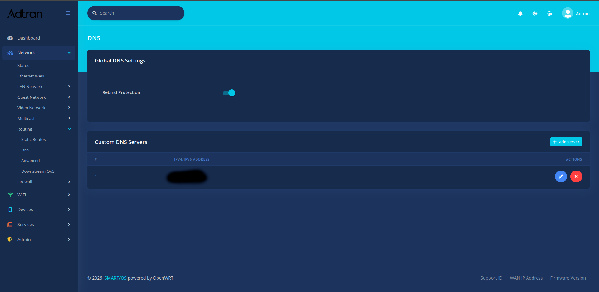

My router is an adtran 834-5. The way I have it setup is added a custom DNS on network-routing-dns menu on the router. I cant find any place to change the primary DNS on this router. Also have a static IP assigned to the pihole and that is working fine.

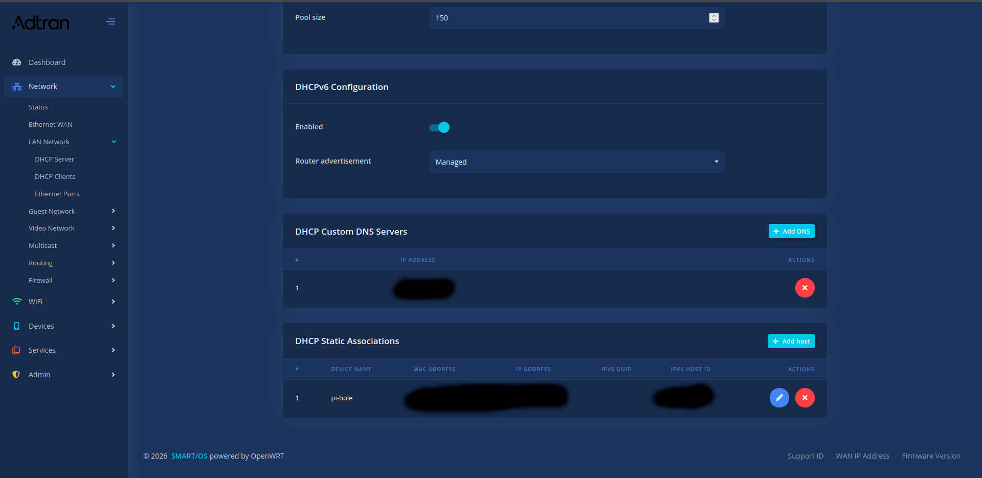

Yes I thought it was a bad idea to unplug but did it anyway. Good to know. I did lose ability to ssh into it from my desktop (current version Ubuntu) and it showed up in my router as not connected so not sure what happened to it. Here are 2 screenshots of the 2 settings I have changed on this router. Again there is no option at least that I can find for a primary DNS. I dont believe it is only WAN setting but could be wrong of course. ip adress is piholes in those settings.
I think you have configured the Router’s own DNS Queries to be resolved by your Pi-Hole.
What happens if you remove the IP Address of your Pi-Hole again ?
I can’t clearly see which page is which by the way and there is no need to hide LAN IPv4 addresses while someone is trying to help you :wink:

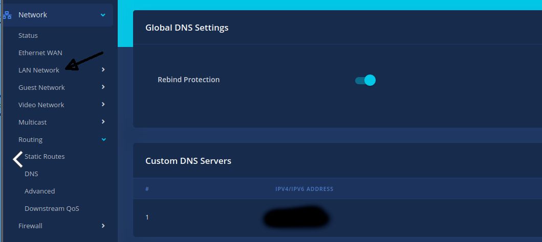

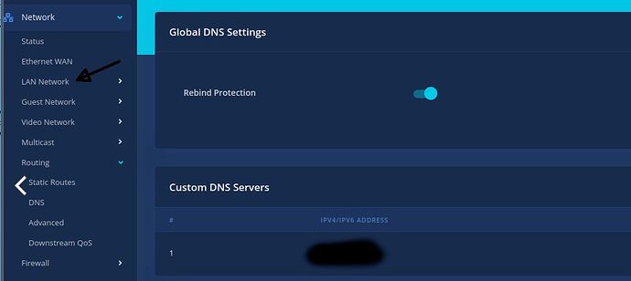

Try the Lan Network
