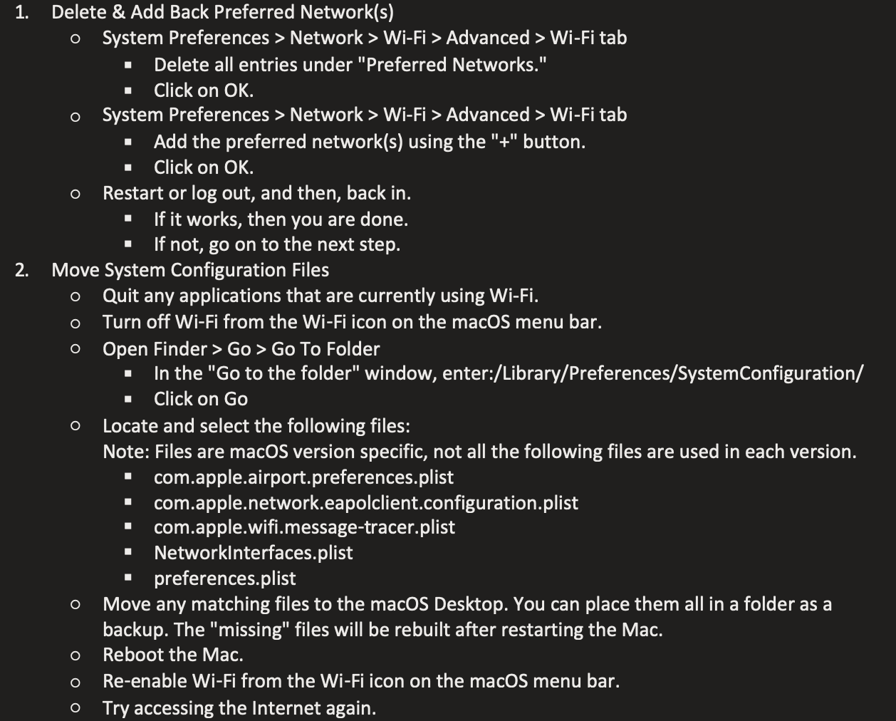

This is more likely a configuration file with your Mac. Give the following a try to see if it will resolve this issue:
Hello - it happened again today, when I manually replaced the DNS server for pi-hole, internet started working fine. So my guess is either the laptop itself, or the Unifi UDM router, which is known to have some bugs in its current firmware. Thanks.
Thank you for your suggestion, but I'd rather not delete all my saved networks along with their passwords. Also, I've noted that if I disable/enable WiFi, it works fine.

@michael_n No problem, it's just a suggestion. I spend a bit of time over at the Apple Support Communities, especially in the networking area, and see this over there, so it's not unique. What I provided you was what has "solved" it for a number of other users having a similar network Internet connectivity problems when their Macs wakeup from sleep mode.
