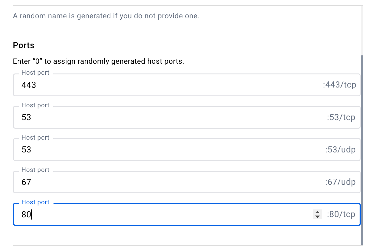

Remapping ports 53 and 67 won't work, even less so if you do map them differently for UDP and TCP:
Clients will send their DNS requests to port 53, the standard port for DNS.
Also, they would broadcast for a DHCP server on port 67, the standard port for DHCP, but even with port 67, broadcasts would not reach your container, as Docker isolates that in a separate link when using bridge network modes (and anyway, you would only need port 67 if you intend to enable Pi-hole as DHCP server).
Thanks for the detailed explanation. So I put "0" for the 4 port values when setting it up. Now I get:

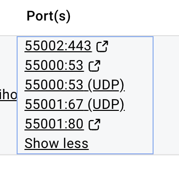

So there are 7 IP addresses listed. What address do I use to access the pihole? With pihole installed in Container Station on my QNAP NAS I access it at http://10.0.0.70/admin/.
The Docker list of pihole ports makes it even more confusing:

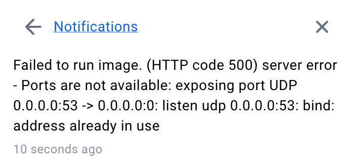

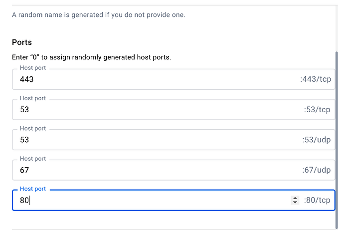

You can't remap 53 and 67 to 0 either.
You have to publish and expose the same ports, e.g. 53:53/udp.

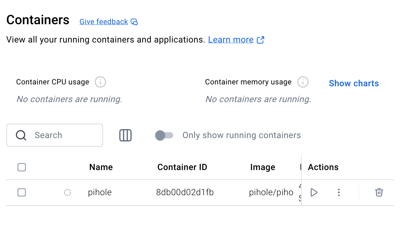

Thanks for your quick response. Tried
errored out
but pihole is my only container
and in macos terminal
sudo lsof -i -n -P | grep TCP
doesn't show that the port is in use.
Tried again this morning and the error went away and pihole started
