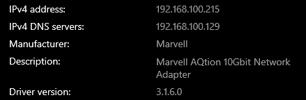

The Windows network interface seems to think the Pihole is the DNS server
Oh my goodness. I don't know what the community guidelines are here on this forum or I'd be using a lot of expletives in this response. I was connected to an external VPN via PIA. I didn't realize I jumped on it yesterday :facepalm: I turned it off and the pi.hole resolution works. Another one for user error.
