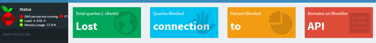

Lost Connection to API [again]
Expected Behavior:
PiHole works excellently
Actual Behavior:
"Lost Connection to API"

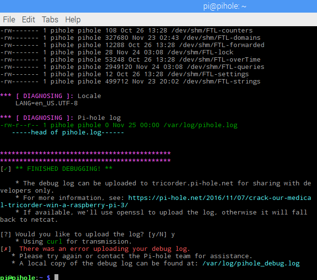

"There was an error uploading your debug log." [Looks like lots of errors shown in the output.]

Noticing the network was running slow again I checked and found "Lost Connection to API" - same situation as last time.

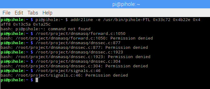

Here's the end of the file as previously requested by @DL6ER:

Run pihole -d and upload the debug log
Hi @jfb. Thank you. The debug token is cuexet0uiu .

I checked your log and see that pihole-FTL was not listening on its ports. I cannot say what happened as both, /var/log/pihole.log and /var/log/pihole-FTL.log are empty in your upload.
Looking at the content of /dev/shmem (also visible in the screenshot you provided before), it seems like your Pi-hole has not seen many(or any) new queries after Nov 24, 03:08. This was roughly four days before you opened your ticket here. Does that match?
Unfortunately, we cannot do much so long after a crash (or whatever happened) as the logs will all have been rotated out of sight by now. Does it work normally when you
sudo service pihole-FTL restart
? If so, simply continue to use your Pi-hole. If it shows again issues, please make sure to back-up the two mentioned log files soon enough (usually one has about 3-4 days time because the rotated logs are not immediately removed by first renamed to .log.1, .log.2, etc.)

Di you re-enable DNSSEC? Looking at your debug log, it shows the exact same crash as discussed here:
I'm sorry that this is still happening, however, there isn't much we can do about it right now as it is an issue with the embedded dnsmasq.
