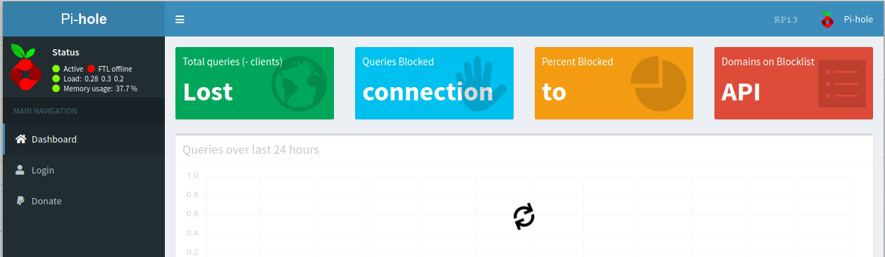

Lost connection to API after power cycle
Edit: After a power cycle PiHole FTL is not running and clients can't connect to the Internet through the PiHole.
Edit2: The RPi serves PiHole, Domoticz and Dashticz (the last one in a container I believe). No other functions on the device. PiHole is setup as DNS and DHCP server for my network.
FTL running. Clients getting an IP address from DHCP (configured in Pihole)
FTL is not running and clients can't get a valid address (all in 169 range)

pi@RPi3:~ $ sudo service pihole-FTL restart
After that the PiHole web interface shows:
Can you make sense of the above?
