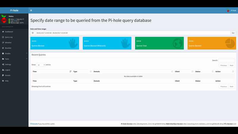

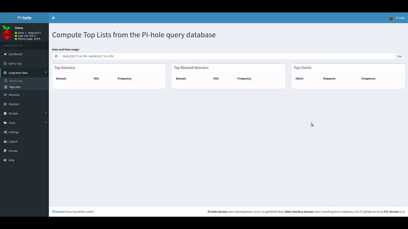

Proposed beta version of the long-term statistics has two functions (so far):
https://github.com/pi-hole/AdminLTE/pull/521
