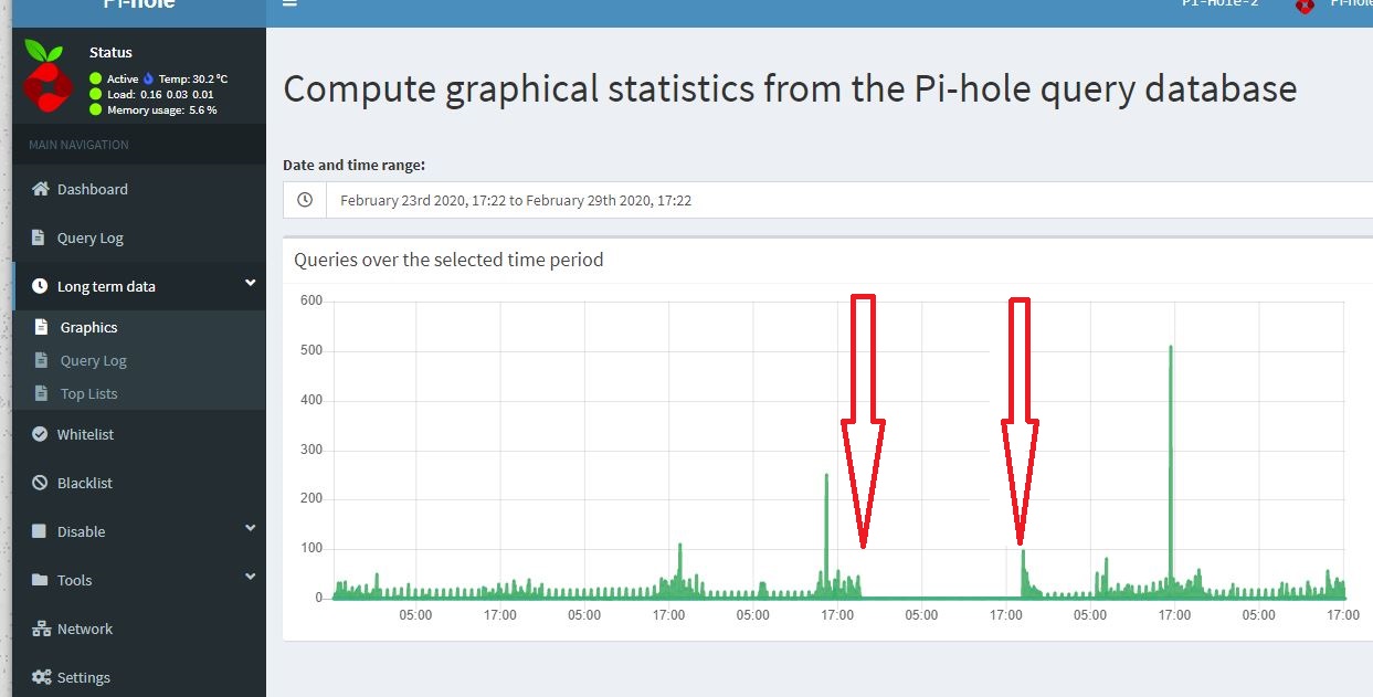

I didn't change the setting at all - for the time until Feb. 26 ~20:00 the long term data shows queries, and starting from Feb 27 ~20:00 (after I pressed the "Flush logs" button and did a reboot) it also shows queries (as shown in the attached jpg)

In your screen shot below, are you sure the data is missing, and not that there just was no traffic to the device for this period? If there is a second DNS available to clients (and particularly the router), the traffic may have jumped to the other DNS server. For the period of missing data, what is in file /var/log/pihole.log

I am perfectly sure this data was gone after I pressed "Flush Logs" @ the GUI and rebooted subsequently.
I can exclude that there hasn't been any traffic - and the same happened to my Primary Pi- Hole.

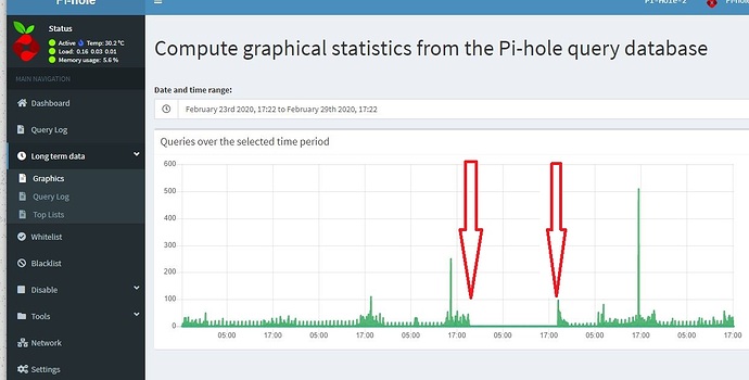

Here the screenshot, just taken:
Network is configured to have only the 2 Pi-Holes as DNS - the router is only queried by the Pi-Holes as conditional forwarder as it acts as DHCP.
