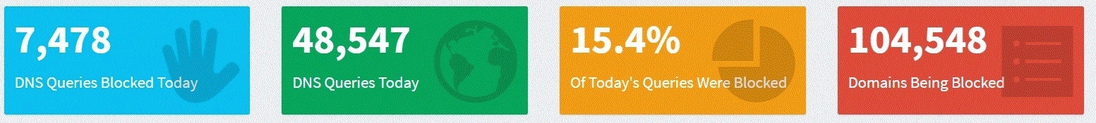

I am also use the FTL dev version for testing.
And I have noticed that the queries counter will not set back to 0 after midnight or after 24h, although they labeled to show the queries of today.
