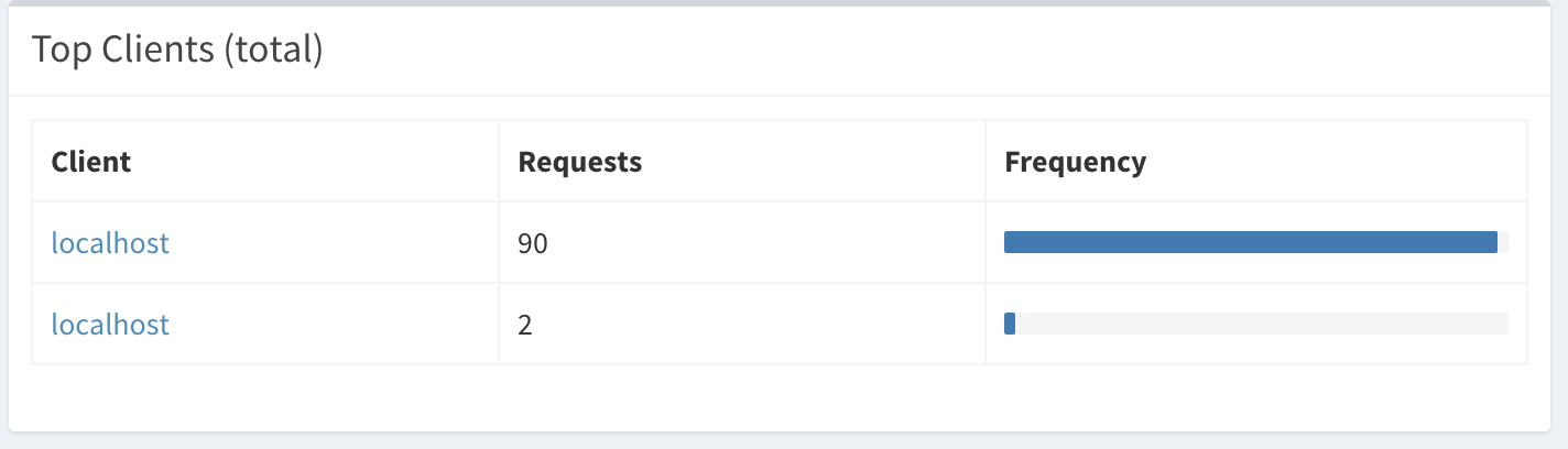

Localhost is the only topclient

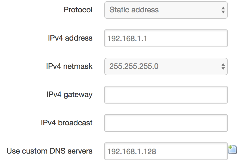

I installed Pi-hole two days ago, and I am still evaluating if it is functioning correctly, as the logs are not being generated in the way that I think they should based on tutorials. I am using a router w/ OpenWRT and edited the default DNS under interfaces ->
When I check this website it says adblocking enabled - Block Ads! Adblock test
Router and localhost will be listed as Top Clients, more logs generated.
Queries will be visible, blacklisting specific sites will work.

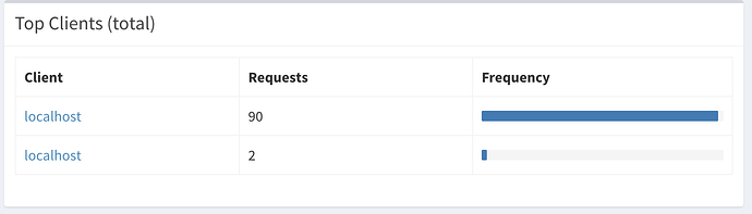

only localhost is listed

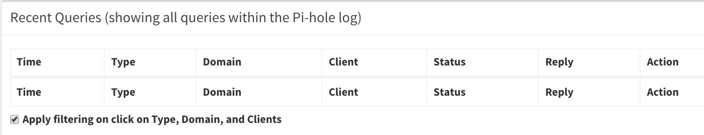

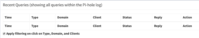

No queries displayed -
Sites added to blacklist not blocked.

And how would I alter the ethernet gateway? The pihole pi is on shown on the router's arp tables and I can ping the router from the pi
