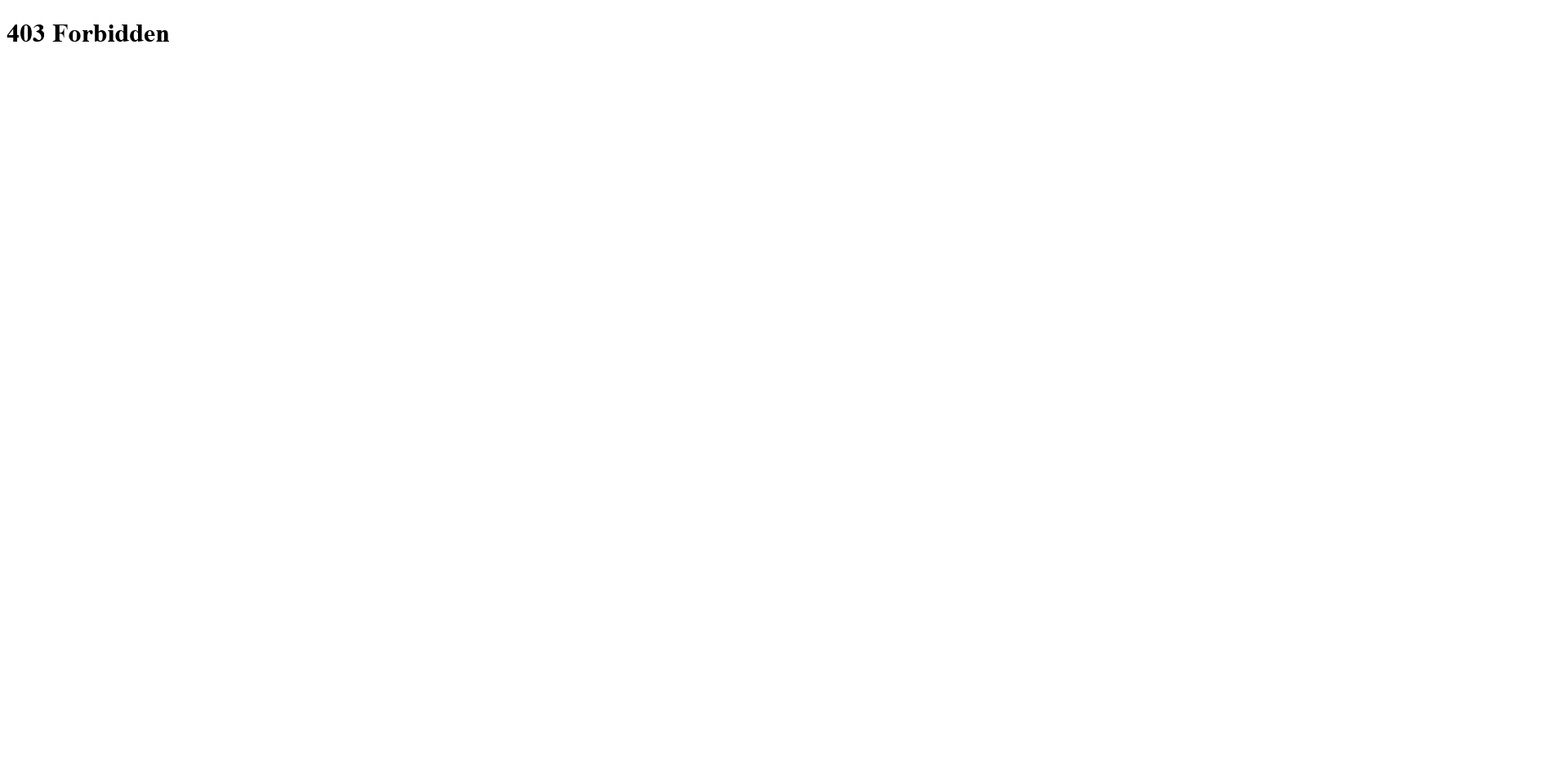

The issue I am facing:
After updating pi-hole to the latest version I can not reach admin dashboard. I get a 403 Forbidden message.
curl -I http://localhost/admin/

The text you have posted shows a 302 Found
response, not a 403 Forbidden
, like you said.

Although I can not access localhost/admin on neither of my pcs on my local net.
Did you try xxx.xxx.xxx.xxx/admin instead of localhost/admin?

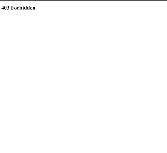

Hello, I have the same problem after updating.
Which URL are you using to access from the browser?

Hello.
Pi-hole
pi.hole
](http://pi.hole/admin)
lets me in, while if I try to access 192.168.50.41/admin it shows the same error. maybe its a resolution error?
Hi and thanks
you had to enter the entire url admin/index.php
There is no DNS resolution when accessing via IP.
