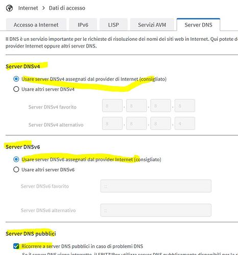

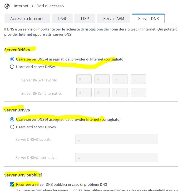

Currently router configuration on DNS session
dns_local_ip6
IP6 DNS Disabled
Internet DNS server
Before the problem IP6 DNS was active , and all IP configurations were pointed to PI-hole server

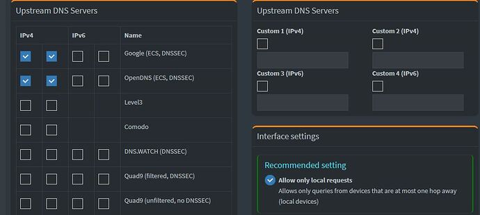

Pi-hole DNS setting (previously IP6 was checked)

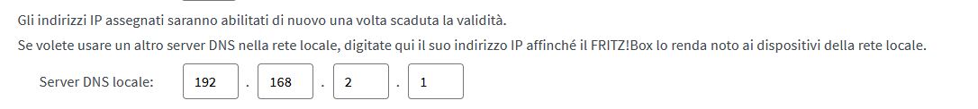

Your debug log shows your router's DHCP server to distribute your router as local DNS server:
   * Received 548 bytes from enp9s0:192.168.2.1
     Offered IP address: 192.168.2.8
     DHCP options:
      Message type: DHCPOFFER (2)
      router: 192.168.2.1
      dns-server: 192.168.2.1
That could still involve Pi-hole if you had configured your router to use Pi-hole as its only upstream (i.e. Internet > Dati di accesso > Server DNS), but you would not be able to attribute DNS requests to individual clients in such a configuration.
And as your debug log shows that you've enabled Pi-hole's Conditional Forwarding:
That wouldn't provide any benefits in that configuration, as DNS requests would have passed through your router already before reaching Pi-hole - on the contrary, you'd have closed a partial DNS loop, probably explaining your observed time-outs.
As FritzBox routers support distributing your Pi-hole machine's IPv4 as local DNS server via DHCP, it would be preferred to use that option, and leave the FB's upstreams with their defaults.
